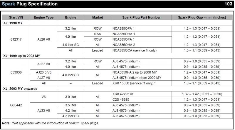

Just a correction with regards to plugs and gaps, attached Jaguars specs:

Originally Posted by xjay8
The correct and only plugs you should be using for this AJ26 engine is:
There is no single spec as there were multiple specs over time and market.
There is also the fact that Estillian runs his particular vehicle at least part of the time on LPG.

Yes....and all that is giving is the Jaguar part nos.
What i have given is the actual NGK part nos which are specific to these engines and are effective world wide other than markets such as Mexico
