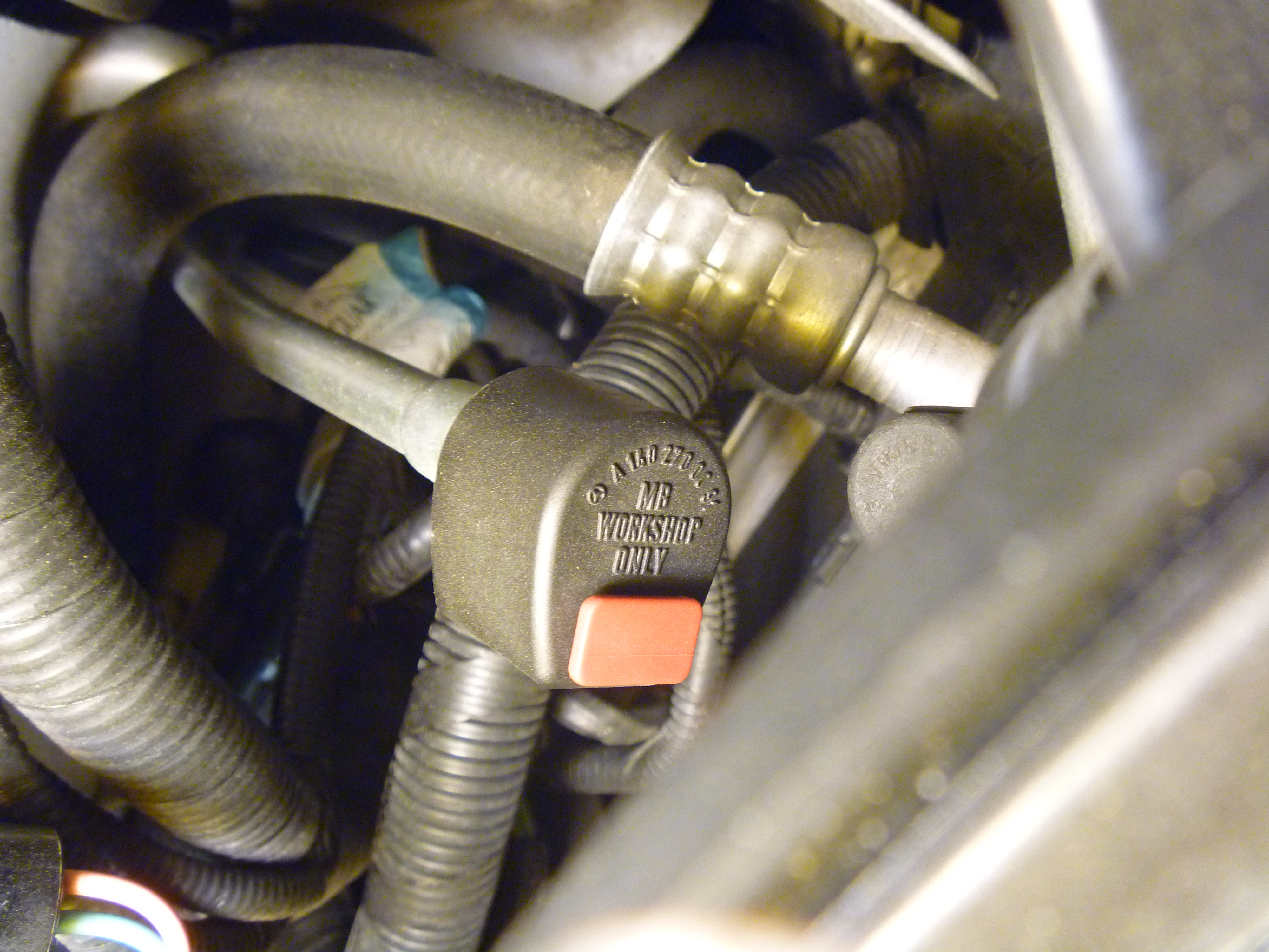

These are pictures of the transmission to help identify it.
Transmission slippage-dipstick3.jpgTransmission slippage-p1020930.jpgTransmission slippage-p1020937.jpg
Is this the Mercedes transmission? There is no filler plug on the side.
Is there a separate code reader socket for transmissions or are transmission codes read through the same socket as engine codes? I know it's a dumb question but I don't know the answer.

Yes it is the Mercedes transmission, yes that is the filler tube photo. The red tab must be broken off to remove the cap. It can optionally be replaced for a dollar part. All codes are read through the same OBDII socket.
Checking the level should definitely be a first step. You will need to purchase a dipstick for the Merecedes 722.6 transmission, widely available over the internet if you do a seach.

I would check the level as stated above but I'd certainly change the fluid/filter. It's much easier than the ZF transmission, MB used clamps to hold the pan and there isn't a issue with getting them off. You refill thru the tube in the eng bay (that u found). Measure how much you drain, then refill and measure.
There are 3 basic problems that occur with this transmission, you might have a faulty speed sensor which you can replace the electrical plate when changing. They are avail on ebay. This is all fairly easy to do.
Read this and there is a good youtube video on maint.
Mercedes-Benz 722.6 Transmission FAQ - Mercedes-Benz Forum
