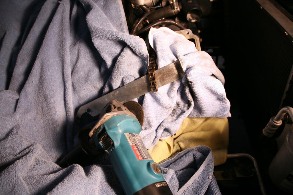

I just installed mine. Ordered it from
JAGUAR 4.0LV-8 UPPER TIMING CHAIN ,WITH MASTER LINK
It's $59.59 part number EAZ1286
I will do a detailed write up on my own post "Tensioner, my turn" early next week. You will need to lock down your cams and flywheel to take off the exhaust cam sprocket. I used a grinder to take off the old chain.

When you ground off the old chain, how did you keep the metal bits from flying into the works and potentially causing mayhem?

I will update my other post with pictures when I get time but the engine bay was covered with towels and a wash cloth stuffed into the timing chain area. Nothing but the chain was exposed.
Ok updated, here is a photo. I used my special tool I made to hold the exhaust cam sprocket as a stop for the grinder (served lots of purposes). The tool used to be used to install pergo laminated flooring.
