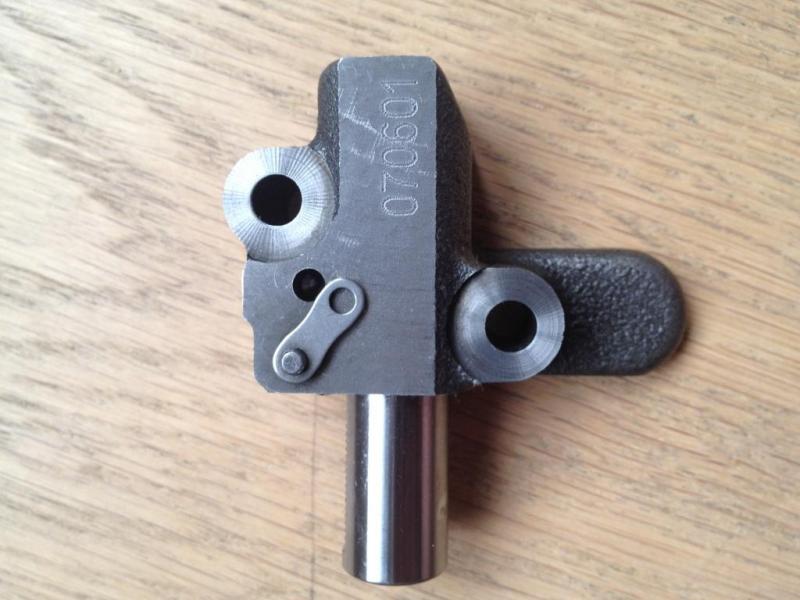

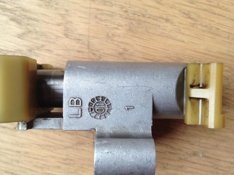

@xjrguy
In the nikasil bulletin, jaguar does clearly mention the solution which was to implement cast iron sleeves. Don't have the bulletin member with me but I am sure you know which one.
I actually may have tensioners with a 2001 date stamp, I'll check later.

Found them:
Attached Thumbnails steel lined cylinders.-img_1823.jpg   steel lined cylinders.-img_1824.jpg

Originally Posted by avos
@xjrguy
Looks like this is one of those "everybody's right" kind of things. The more I dig, the more places I find each term; steel and cast iron in references to the cylinders for V8's.
Strangely, on the V6 it seems to be steel or "dry steel" when describing that engine.
Lookin' forward to the early date stamp, I've sure never found one.
Cheers,
Found them:
Well isn't that a kick!! Now, somebody, somewhere, knows the real story here. I wonder how long it's gonna take to find 'em.
So much for getting "accurate" information from some technical people within Jaguar.......
Nice job, avos! [I love this Forum.........]
