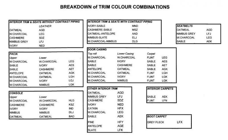

I found these on the forum last week. It DOES NOT give wood colors tho:
