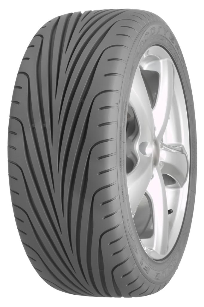

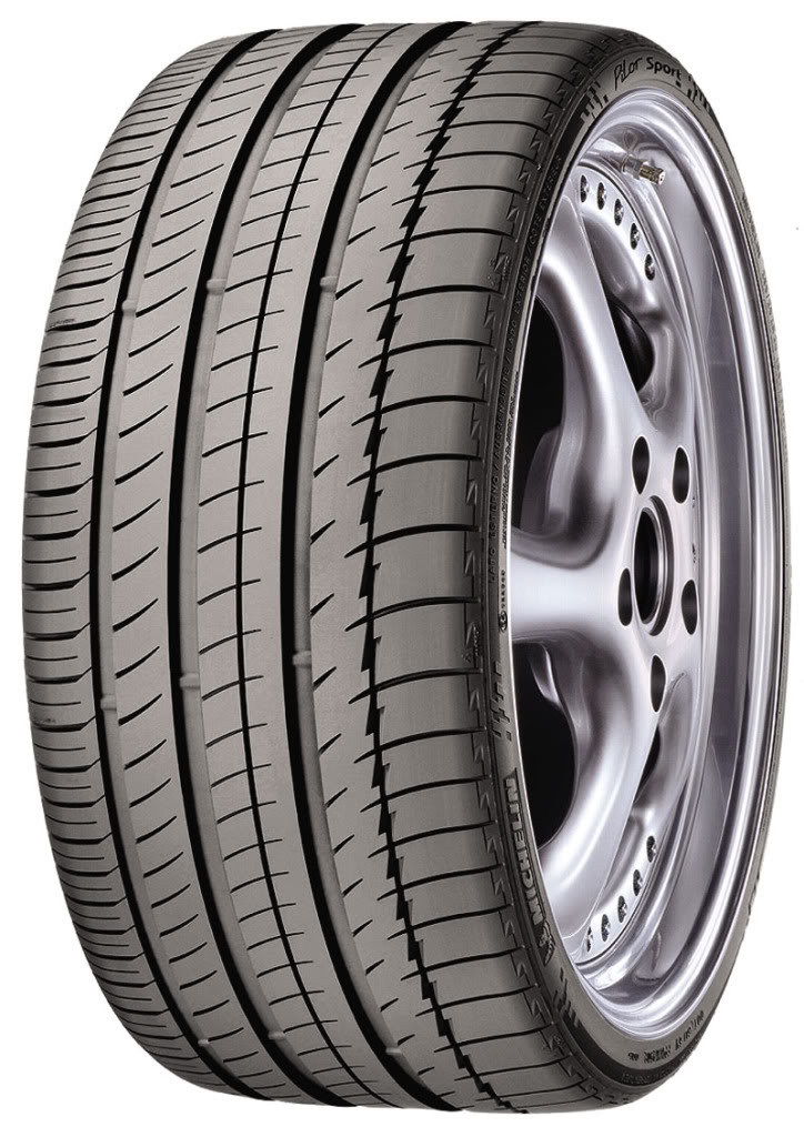

I've had the shimmy at 50, turned out a rim had shed a wheel weight. A quick way to confirm is swap the rears to the front and see if it makes any difference. But you're taking to the tyre shop so this will get sorted.
You might have a bent/egged rim with the pothole.
These cars require an Asymmetric tread design.
They HATE these...
And LOVE these...
Fitting assym patterns almost gets rid of all wonder, to give a more sporting direct feel.
Attached Thumbnails Steering wheel shake at 50MPH-goodyear-eagle-f1-gsd3.jpg   Steering wheel shake at 50MPH-potenza_re050.jpg   Steering wheel shake at 50MPH-pilotsport2.jpg
