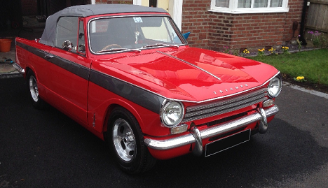

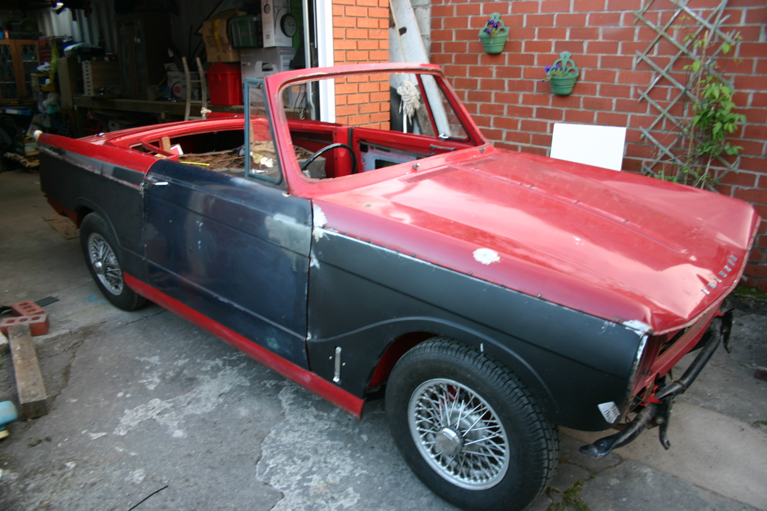

Here's a couple of photos of my Triumph Herald, my little girl, before and after she went into the paint shop. The guy who painted her is a family friend who paints trucks (big rigs) for a living, the little Triumph looked lost in his booth. He is based 60 miles away, but it was well worth the trip in my opinion.
The colour is Jaguar Phoenix Red and Renault Tungsten Grey Metallic. She was painted in 2012 and still looks as shiny as the day she came out the shop. I've ditched those naff wire wheels too.
