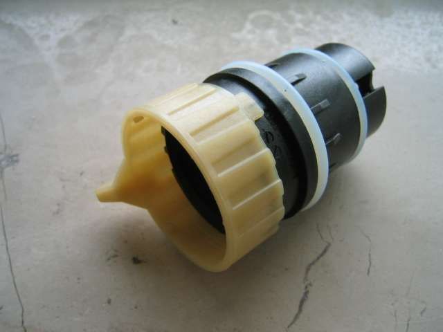

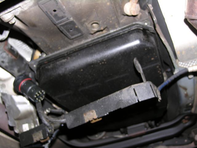

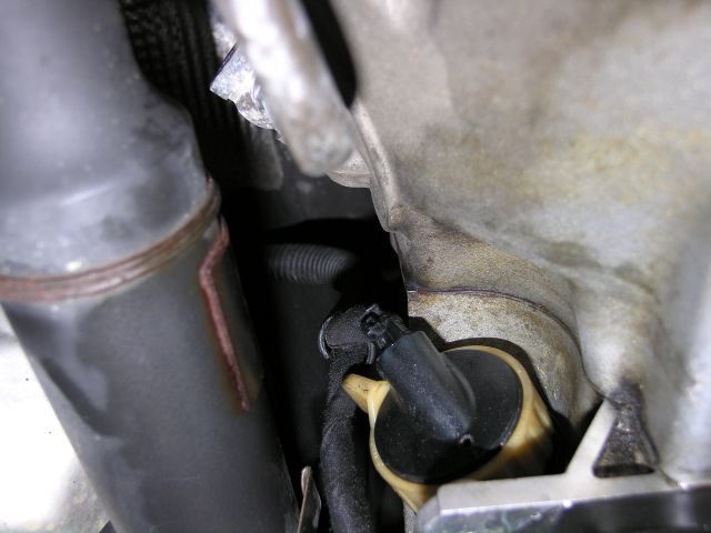

I had the same incorrect gear ratio code in my 03’ SV8 when I got it back in June of this year with 115K miles on it. My transmission electrical connector was wet with oil. I took the pan off, replaced the electrical connector, replaced the filter and pan gasket. I then cleared all the codes in all the modules followed by a hard reset. Driving it regularly and having a good battery has yielded no further issues with the car. If I were you, I’d insist on having this repair performed prior to having them shotgun another transmission in its place of the current one. I’m not saying it’s impossible that the transmission is bad, but the likelihood that it is, is far and few between. I believe the mileage and year of your car reflects that it’s been sitting a lot and it’s more likely that the battery doesn’t provide enough amperage and voltage during engine cranking to satisfy all the modules in the car is more likely the cause. Throw out the idea that the engine cranks up and runs just fine, it’s more complicated than that. *IF* by some chance the transmission comes out, make sure they replace the rear main seal AND the cap seal 2” above it. It needs a 17mm Allen socket to remove it. It’s not just mileage, it’s age also.
This is transmission electrical connector you will want to replace.
