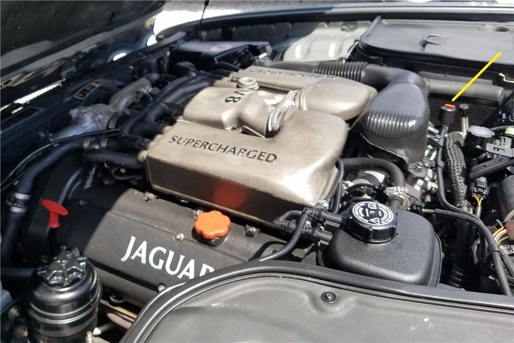

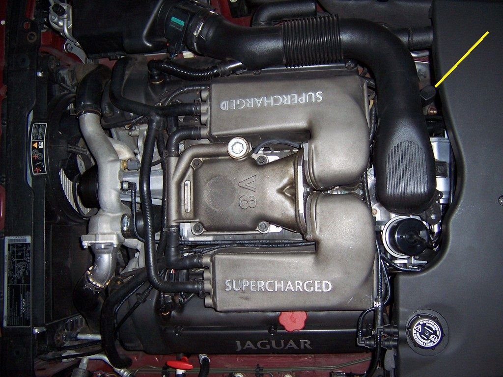

So you have the SC V8, which means you have the 722.6 trans. You don't have a dip stick per say, you have a red tab capped tube where you have to purchase a separate spring dip stick.
This should help, I fail to understand why the combo kits are way more expensive than buying separately?
https://www.ebay.com/sch/i.html?_fro...stick&_sacat=0
https://www.ebay.com/sch/i.html?_fro...722.6+dipstick
...and finally a get to the point video of checking it...
Old Dec 21, 2020 | 08:50 PM
M. Stojanovic's Avatar
Joined: May 2017
Posts: 1,699
Likes: 897
Dipstick tube (capped):
