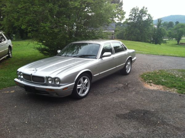

Ok just found that the driver's side back cylinder is damaged. I'm not going to fix it. Will place car up for sale for around $2000.00. Or I may part it out.
Old Sep 26, 2012 | 05:02 PM
Shane8362's Avatar
Joined: Aug 2012
Posts: 22
From: Virginia
Default Sale or parting out
One cylinder is damaged, car ran great till that happened. Sale for $2000 or parting it out.
