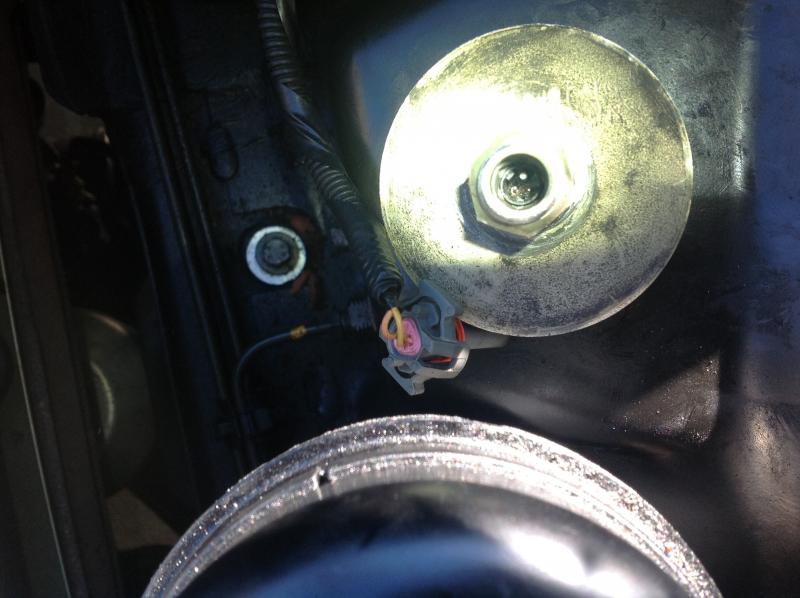

Originally Posted by princemarko
They showed me the computer and said Open Circuit on both. They want $1400 with labor.
Pins are there and not recessed.

Old Feb 2, 2013 | 09:30 AM
rocklandjag's Avatar
Joined: Nov 2009
Posts: 753
Likes: 220
From: New York state
Princemarko - I measure 1" from the very bottom of the cavity for the pins to the top of the nut. What does yours measure?

From: Tampa
We took the nut off and inserted the connector, still same open circuit readout
