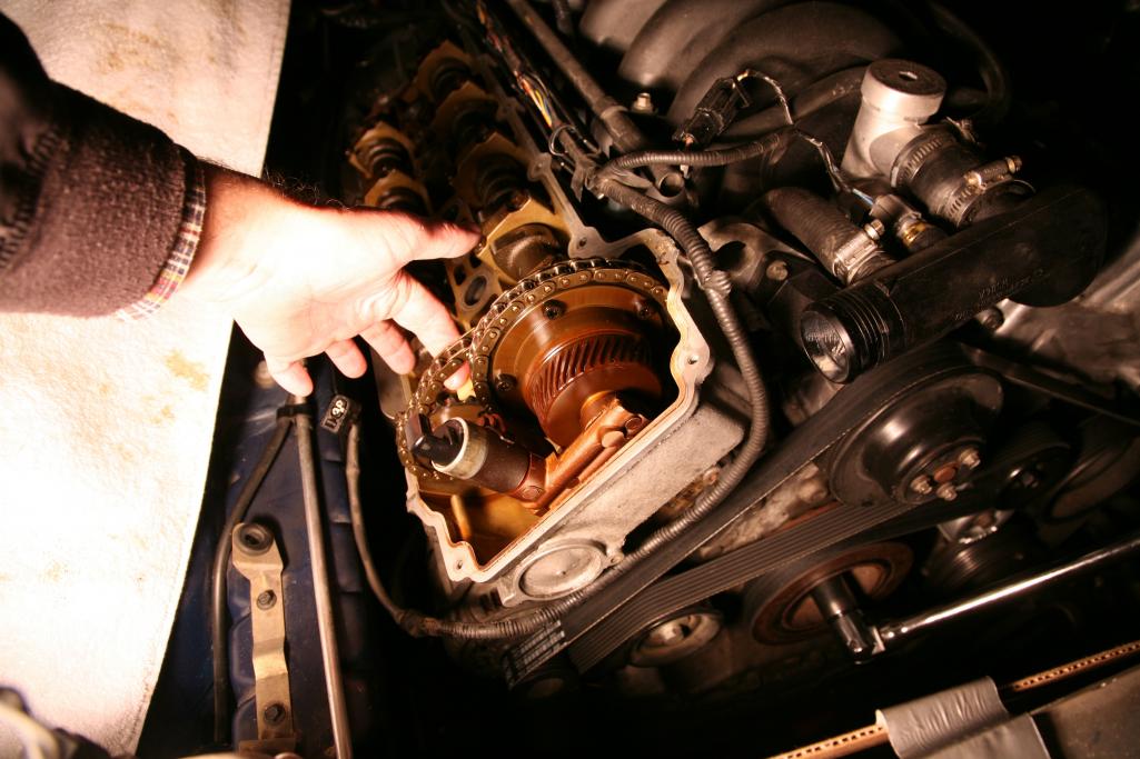

First I want to thank everyone past and present who has contributed to this web site. I knew going into ownership of my Jaguar that I would be facing some issues (tensioners). Just hoping later rather than sooner.
Our honeymoon lasted about a week from purchase when my 2001 XJR (born on date 11/00) told me I needed to start paying more attention to it. I started it up in a parking lot I had just stopped at when the check engine light (CEL) came on, the warning about limited drive mod, and it was shaking a bit fierce. I drove it to a auto parts store to get the codes read. It came back as number 1,2,3,4 cylinders were miss firing. I bought some plugs to put in relieved that it was not worse than that and put the plugs in by using instructions I found here. The plugs I pulled from the right side (as if you were sitting in the drivers seat) were all black and wet. My guess those cylinders are number 1,2,3,4. The plugs on the left side were all white and dry. The cam covers also had a bite of rust by cylinder 7 and 8 which is right up against the coolant overflow. The previous owner did say they had to replace the thermostat. Must have been an overflow issue.
Put everything back together and hoped for the best. Nope, ran just as rough if not worse. The engine light even started flashing rather than being a steady light so I parked it and retreated back to the computer.
Today I took the cam covers off. Should have done this when I changed the plugs. Was just hoping for the best I guess. The chains are still in place. The left side is perfectly fine yet. The right side I was praying the chains were still on which they were. The tensioner has come apart in at least two sections. One piece is the rail that the chain rides against which I retrieved with a few little pieces missing from that and what I would call the back side. I will try and attach photos if I can here.
So I am in need of the tools to complete the job if anyone has one they don't mind lending, renting, selling. Otherwise I will go to the Ford or Jaguar dealer and get them sell when I am done. In the mean time I will start draining the oil and coolant. Is it required to take the hood (bonnet) off to do this. So far its been pretty easy working around it.
I'll take any other input as well. Especially if there is something else I should be replacing while I'm in there such as water pump, hoses, belts, pulleys, ets. Also, do I need to be checking the condition of the tie rods and such before I start spending too much money. I did read somewhere that I could pull the plugs and turn it by hand to listen for unusual noises but not sure what it is I turn by hand. I am not too much experienced with this kind of work but I have google as my friend.

First, welcome to the forums.
What you would be turning by hand is the crankshaft centre bolt using a 24mm socket on a breaker bar. clockwise only. You will need to remove all sparkplugs to turn easily. Make sure you stuff a paper towel into each sparkplug hole if not actually listening.
The stickied threads in the XJ8/XJR and XK/XKR should be useful to you in regards to the engine.
You will read about the zip-tie method. It is probably not for you, because you may have already skipped a tooth on the exhaust cam.
You may not need to do the primary tensioners/guides as it is the secondary tensioners which usually do the grenade routine.

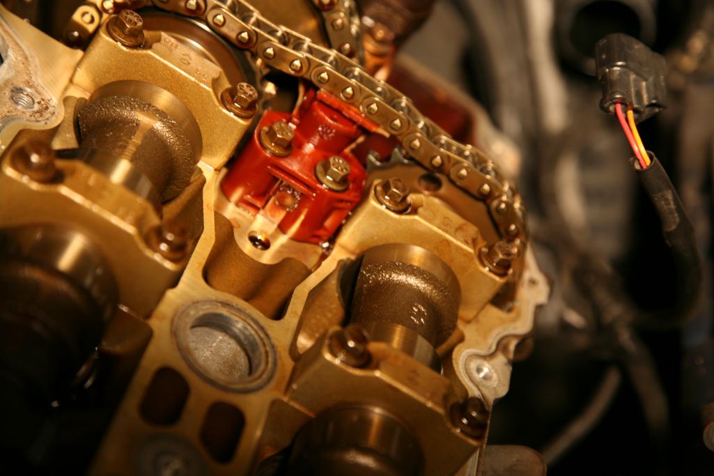

EZdriver - thanks for the input. I looked at your pictures and compared with what I have now. Looks like I had three pieces break off. One I've retrieved so far after taking the cam covers off (photo attached) and the two side supports have a piece broken off (photo attached) which I still need to retrieve. In my photo of the tensioner you will see the white marks just above the mounting screws, that is where the plastic supports also broke off.
I did take the hood off as well. After taking the struts off the hood I looked at the hinge bolts and thought what the heck. It took me 10 or 15 minutes to do. I guess its comparable to renting a hotel with a ocean view. Just gives me a different view but the rooms are still the same.
Attached Thumbnails Tensioner, my turn-broken-piece.jpg   Tensioner, my turn-img_5116.jpg

Looking at your pictures and how slack the chain is I would bet that you have jumped more than one tooth. If so you may have some bent valves. As it has been described to me jumping one tooth causes some rough running. Jumping two causes really rough running which is what I think you describe. I really hope I'm wrong. But I would do a compression check after you replace the upper tensioners and before you put everything else back together. Bent valves means pulling at least that right hand head. Keep us informed.
EZDriver

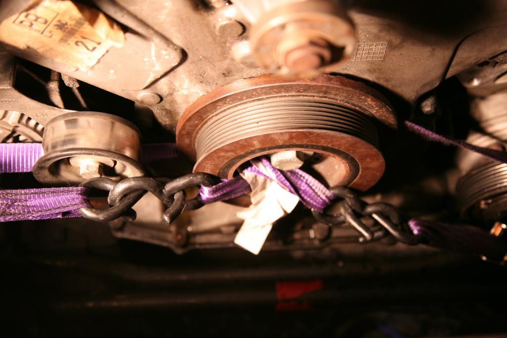

I did commit my first stupid blunder (hopefully its ok to admit that here). When removing the accessory drive belt tensioner pulley. I pulled on the 15mm nut used to loosen the belt rather than the 13mm bolt just below the pulley (picture attached). Now I have to repair that as well. Must be a left hand thread. Hopefully there is a replacement bolt without having to order the whole assembly. Looks like I can buy the part new from partstrain for $88.95 its part number W0133-1800578
What is the correct tool to remove the Crankshaft Pulley?

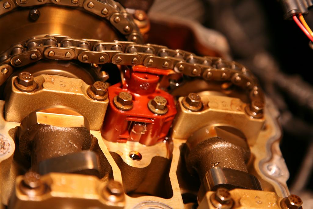

I'm trying to remove the 24mm bolt holding the Cam shaft pulley on. How critical is it not to move the cam in the reverse directions (counter clock wise). In other words will I do some damage if it my locking method slips. I have attached a couple nylon tie down straps around the sprocket and around the frame on each side. Picture attached
I did turn the cam by hand (clockwise) to line up the flats on all 4 cams. One cam on the right side is off compared to the other 3, but it appears to be by one tooth only. Just by eyeballing it I moved the cam by one tooth and it appears that the one out of alignment with the others moved to a position that would would have been alignment with the others. Picture attached showing how far the cam is off to the other.
Attached Thumbnails Tensioner, my turn-img_5121.jpg   Tensioner, my turn-img_5120.jpg

Why are you removing the crankbolt? Are you doing secondary and primary?
Doing only the secondary does not require removing the timing cover.
Doing both usually requires full lockdown.
So, right now it seems to be you have a bit of both and that might not be a good thing.
edit: if post #9 is still true, you have gone too far. you need to read up on either the zip tie method for secondaries only, or the lockdown method.
in either case, you will have to modify your procedure to bring the one cam into proper alignment.

Yes I only plan on replacing the secondary's at this time. I have plastic that has broken off the right side tensioner. I have not retrieved all the pieces of plastic and was thinking I need to take the front off to find those. Also thought it would be good to check the primary tensioners.
For now do you think I could get away with installing the secondary tensioners using the zip tie method and at the same time when I loosen the cams themselves just turn the one that is off and reposition it on the chain?
Old Apr 9, 2011 | 08:57 PM
plums's Avatar
Posts: 9,733
Likes: 2,202
From: on-the-edge
Probably more than half of the people replacing their upper tensioners have had bits of plastic missing.
The usual advice is to leave them be as they will tumble into the oil pan. Then the screen on the oil pump pickup will prevent them going back into the oil pump. Some people will drop the pan to retrieve them.
If you open up the timing chain cover without knowing the full lock procedure, you will end up in a heap of trouble.
It looks like you might not have the lockdown tools. Therefore, look for multiple threads on the zip tie procedure. Read them all. As each is a bit different, that will give you a better understanding of *why* each step matters.
To compensate for the fact that you have a slipped chain, you might try lining up the three flats, line up the last flat as requred, and only then consider yourself at the start of the job.
Do not try using a procedure that encompasses both primary and secondary, that will only confuse matters.
