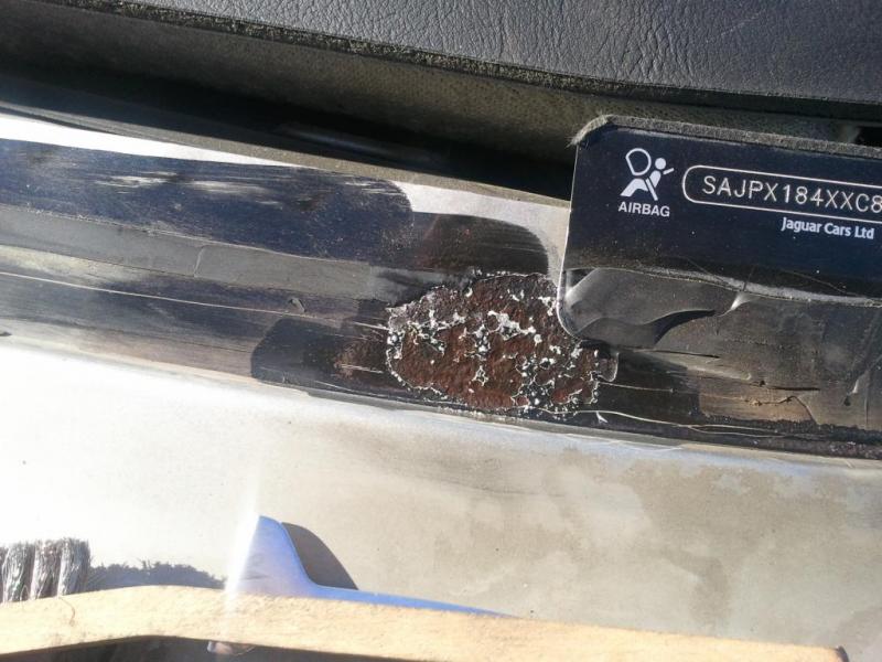

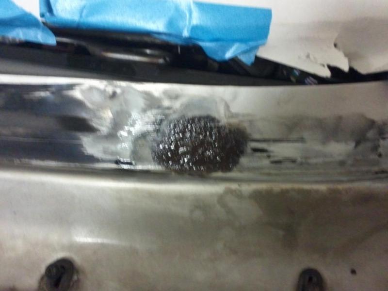

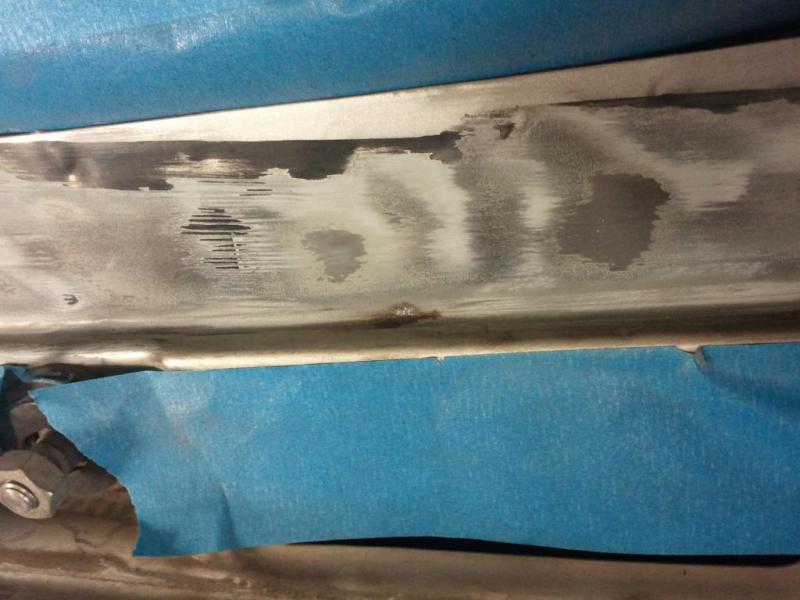

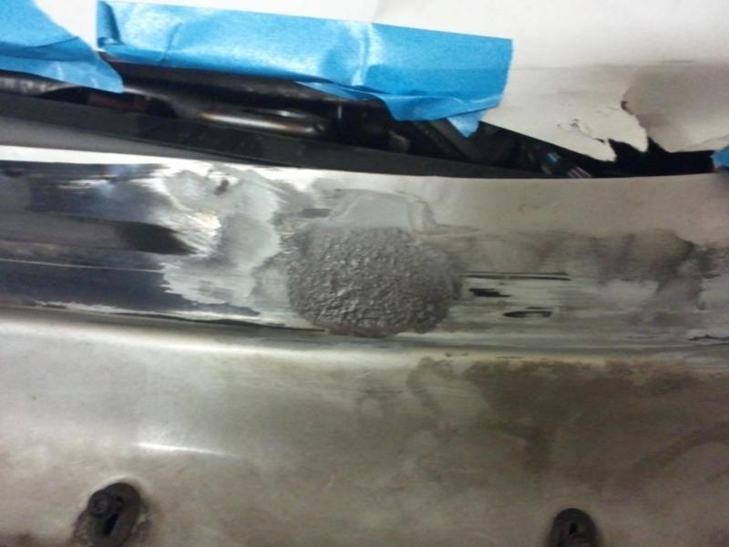

If you can, watch your windscreen being replaced !!!!
I had a crack start in my windshield (all I'm saying is it appeared after I put on a new wiper blade)
Safelite came out to install it at the house, he got the glass out and I was watching, as he scraped away the old sealant we found a rust spot next to the VIN # Plate.
Before doing anything
After wire brushing
After phosphate treatment
and down the passenger side(smaller)
He advised repairing the rust and decided to order a new surround rubber as he said the old one might be too old (car is a '99 with 203K on it) surround is covered under insurance as it's part of the windscreen assembly.
So I'm sanding and treating the areas with Klean Strip phosphate strip and prep(home depot $16 a gallon). wait 24 hours and then etch primer and paint
prior to putting a new windscreen in. Safelite will call me when they get the surround in.

Good catch Roger- I wouldn't expect to see rust considering your locale, but it looks like rust can strike anywhere eh?

Hi Dave,
Don't forget I lived at the beach for 14 years, and he said the seal rubber looses it's flex over time. so that's why I thought it important to show, so that others can see it's important to watch replacement

If the car was by the ocean for 14 years, you better check the rear glass too! If it was parked outside (even shortly) the morning dew penetrated behind all the seals, and that morning dew is LOADED with salt. I know,....I have a boat on the ocean. You would not believe how much rust I'm cleaning and treating every season.

Daniel, Car needs a complete repaint due to ocean air and carport parking at the ocean, I was going to have the front and rear screens pulled during the repaint, and have a new headliner fitted while in paint, so yes I will be checking the rear screen, probably in the spring (April) I was really surprised by the rust spot.
For general info the screen cost $115 the rubber surround is $250 and not in stock, I have Safelite scouring the country to find a rubber surround.

Well here is the update.
I fixed the rust spots, the rubber surround is on backorder in the US so we cut the lower section off that was damaged and used universal trim to fit the lower edge.
Safelite are going to wait for the surround to come in and then hold it until I need another screen (AZ is a bad area for stone hits due to desert terrain)
The surround costs $250 so my advice is if you find an undamaged one at a wreckers yard or on ebay buy it.
Safelite says the surround is only good for fitting a couple of times as it does get damaged.
The independent tech who fitted the last screen should have reported the damaged but didn't and that probably caused the rust area (water intrusion below the screen)
