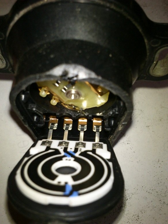

Please if you may let me know what are the tracks so its been said are to do with a Throttle Body on my friends XK8 1999 4.0 LTR. This TB has been sent to a recondition center and it was mentioned by them of these tracks. Please let me know if you can ASAP. Thank you.

The shaft has copper wipers that make contact with radial tracks in the circuit board on the end caps.

Also look on the TB thread in the XK section.
