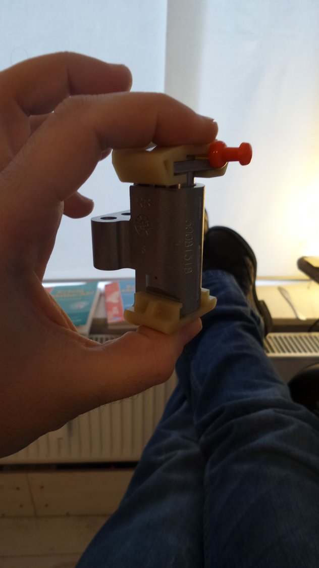

Hello Guys,
My XJ8 4.0 has a broken timing chain tensioner (right side, top tensioner) and I wanted to replace it with the newer aluminium tensioner. I read that the bolts are shorter, but that wasn't an issue. The problem is, the new tensioner is too short. It doesn't reach the chain at all. No tensioning possible. (I removed the security pin)
Any idea, what the problem might be?
Sorry for my bad English
Best wishes,
Daniel

Are there different types? I ordered one for a Jaguar Xj8 4.0 X308 and thought that information would be sufficient. Maybe the seller made a mistake. But it really looks like one these
JAGUAR XJ8 XK8 XKR V8 S TYPE TOP TENSIONERS C2A1511 AND C2A1512 | eBay
Are there smaller ones with the same design?

You might try turning it over and make sure you are not mixing right and left. But why did you buy the one for the S-type, vice the Xj8?

I doubt there is another tensioner similar to the Jag. Could you be attempting to install the left one on the right side? That may be a stupid question, but I don't have a good picture at hand.

I installed it so that the moving part (tho part with the red pin ) is facing down. (I removed the pin, btw )

Don't know: the part looks right, and matches pictures from the ones we buy in the US (mostly from Christopher Foreign Parts).
Try to reinstall the old part to see how it goes. And copy on the new one. It will pump up with oil pressure, but it should keep chain on the cogs once you pull the pin.

From the pictures, it looks to me there is indeed a difference in the height of the lugs between the left and right tensioner. As said, most probably a mixup.

There is absolutely a difference left vs. right. The slipper that moves should be on the slack side of the chain. When you say right hand side, do you mean sitting in the drivers seat, and not looking at ithe engine from in front of the car, correct? That would make the moveable slipper face down on the right side, I believe.
