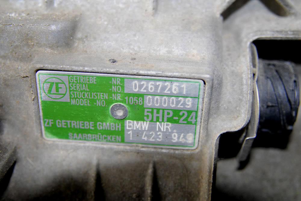

If possible please to post a picture with the green plate from the gearbox (when you will see it removed), I am curious what series it is.
I don't think I'll be there when it's being removed, but if I am, could you please be a little more specific? I might be able to ask the mechanic to take a photo or make a note of what it says, but I want to be able to ask him specifically.
Thanks.

It's the plate on the left part of the gearbox.
Thanks, I'll do my best to get a photo of it.

The mechanic who will be removing the transmission tomorrow has agreed to email me a photo of the green plate as soon as he takes it out. I should have it tomorrow sometime.
