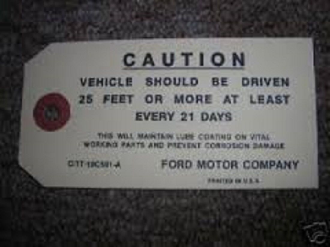

Tag pic below, was a tag that was installed in new Ford cars in the '60's.
Alden
