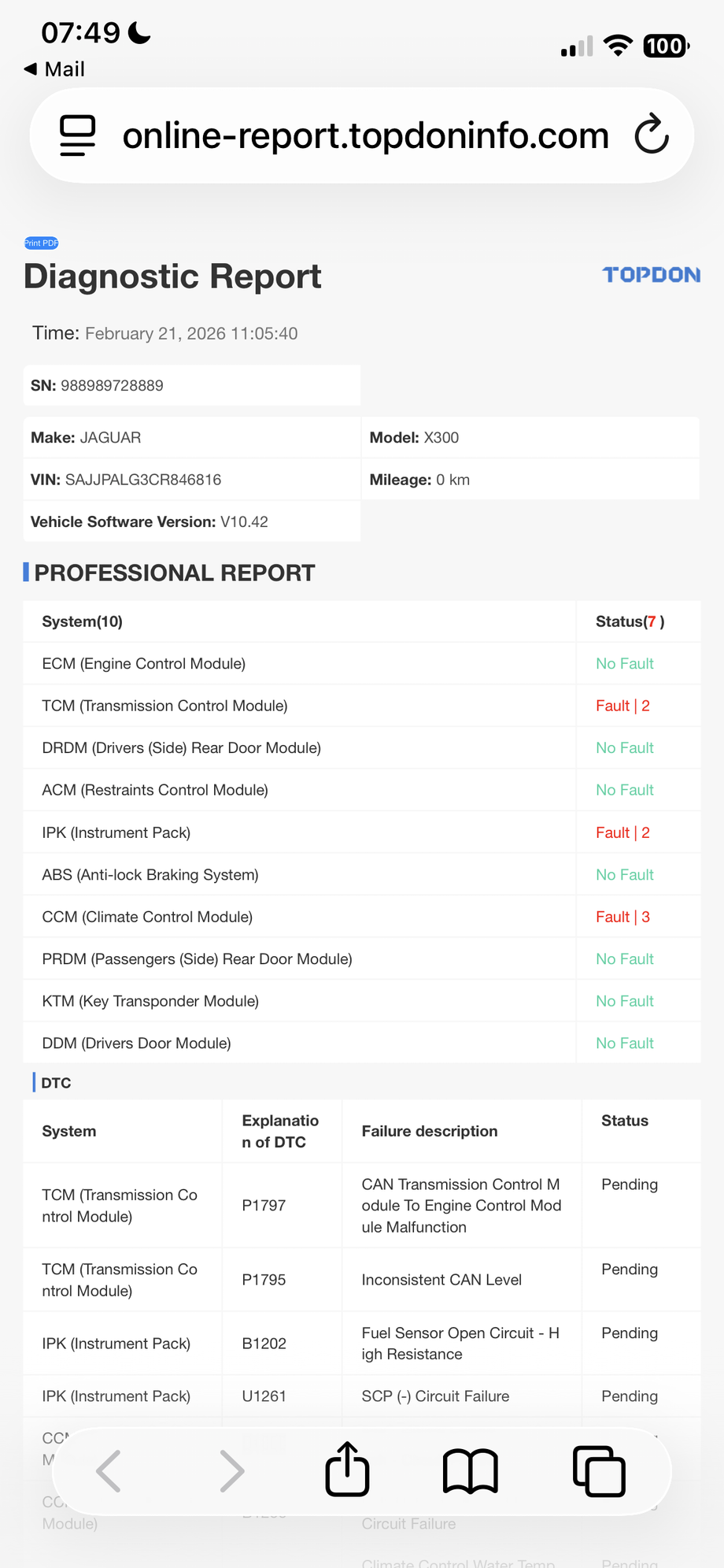

I’m new to the forum so hi everyone. I bought a 1998 Jaguar 3.2 X308 a few years back as a kind of impulse purchase. It hasn’t been driven anywhere since but I do start it up occasionally to make sure everything still works. Anyway to the point recently I tried starting it and it will crank but won’t start. I first of all tries “easi start” if that’s the correct brand name just to try and establish if it was a fuel or ignition issue. It did start briefly but stalled after a few seconds. This led me to believe it’s a fuel issue. After plugging in a friends diagnostic scanner thing I got a few error codes which I’ve attached in a screen shot. Any advice on where to start looking for the issue woukd be much appreciated. Thanks in advance for any assistance.

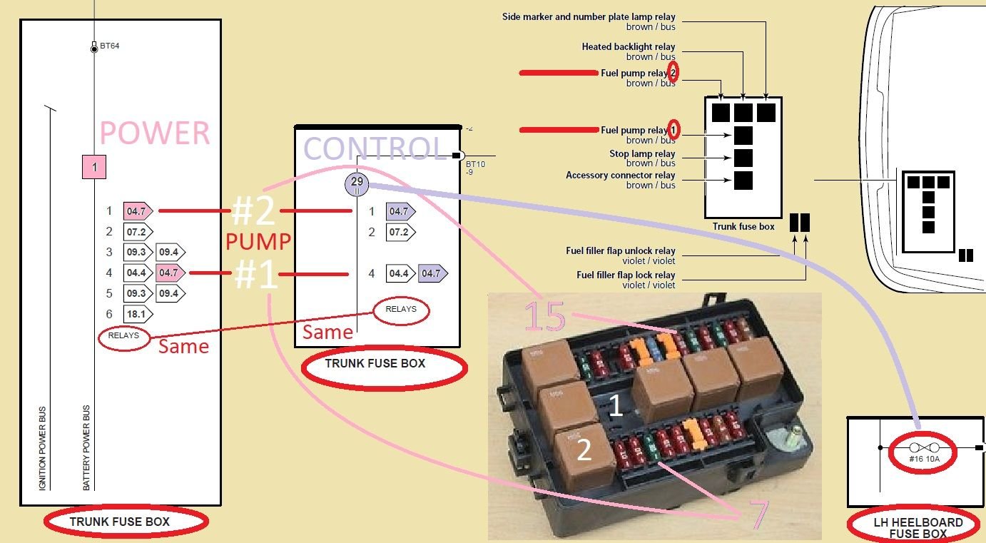

There are 2 fuses for the # 1 fuel pump , relay control and pump muscle power
The control power fuse has to have the relay in the corner of the fuse box close unlike the bigger muscle power as fuse in trunk
The fuse is X in the Y fuse box as that corner relay , the relay may have a swapping option of same part #
Old Mar 5, 2026 | 01:01 PM
Parker 7's Avatar
Joined: Aug 2021
Posts: 4,673
Likes: 1,323
From: Kansas City
Page 42 , looking
29 circle double hash is X with the relay requirement , 1 square is the muscle power
Somewhere in the past I came up with fuse #16 but I can't duplicate that today
Place finger on the # ! fuel pump relay and feel for click ( 3 clicks as a fully functional control on through having started if it did ) 2 clicks would mean.........................

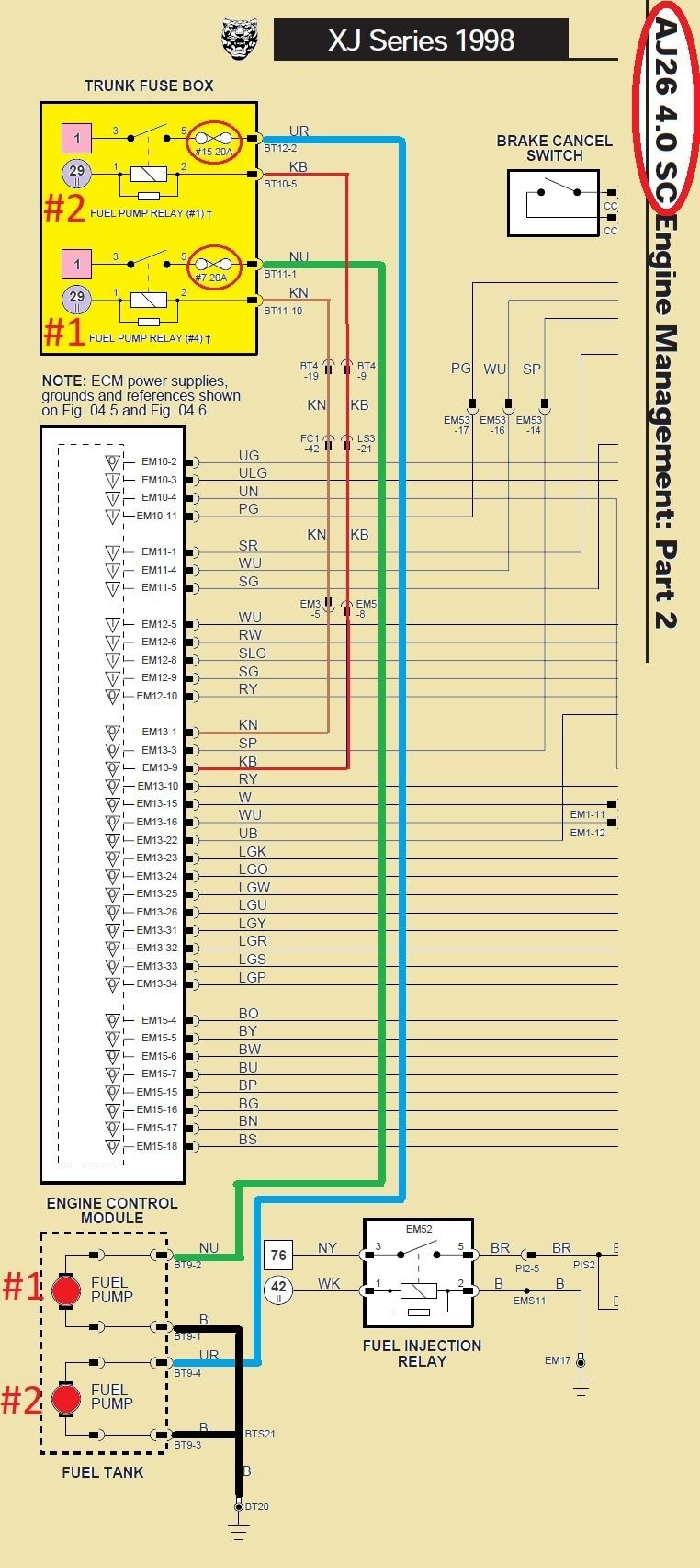

the fuel pump is mounted on top of the vertically mounted ( just fwd of the trunk fwd liner ) tank with the connector outside but fwd of liner , you can read it from the relay as socket 5 to car frame ground
there are provisions to have 2 pumps ( supercharged ) in tank so 2 connectors , 1 unused
notice how the big pump motor muscle power fuse is between the relay and the pump motor
