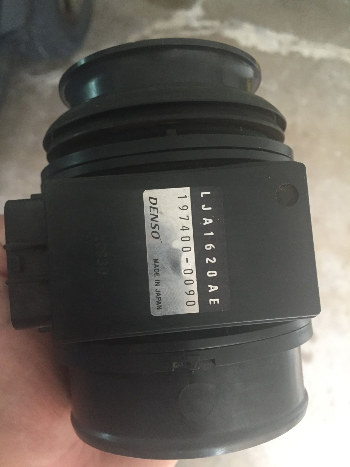

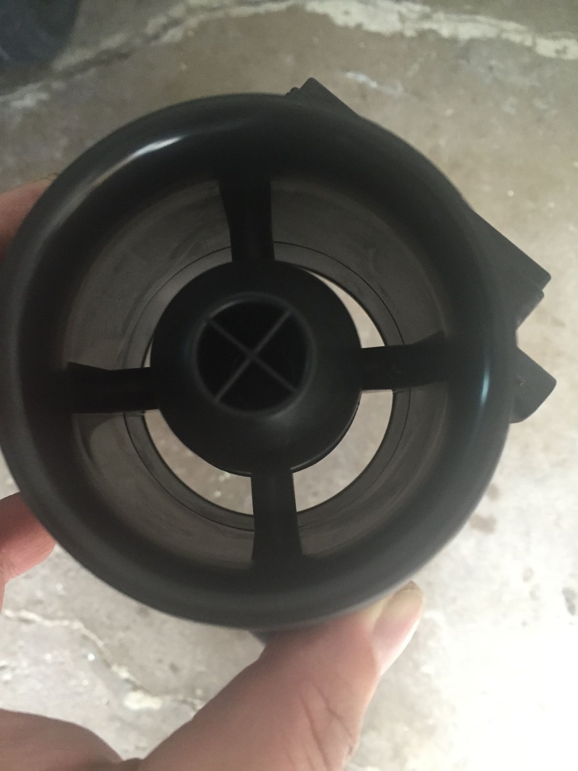

However, after re-assembly i'm still not a whole lot better off. I'm leaning back towards the MAF Sensor. Got a OBD Reader (ELM327 WiFi) and an iPhone app that can access the MAF output (OBD Fusion). I can now see the air flow is over-reported.
I've had the MAF unit out, since it's a '98, the hotwire and temperature sensor don't just pull out for cleaning like I've seen on a few posts.
Is there any way to expose the hot wire? I'm not convinced spraying the MAF Cleaner into the hole in the center of the unit, where the hot wire lives is effective.
The Hot Wire is below the cross in the center
Part # label
