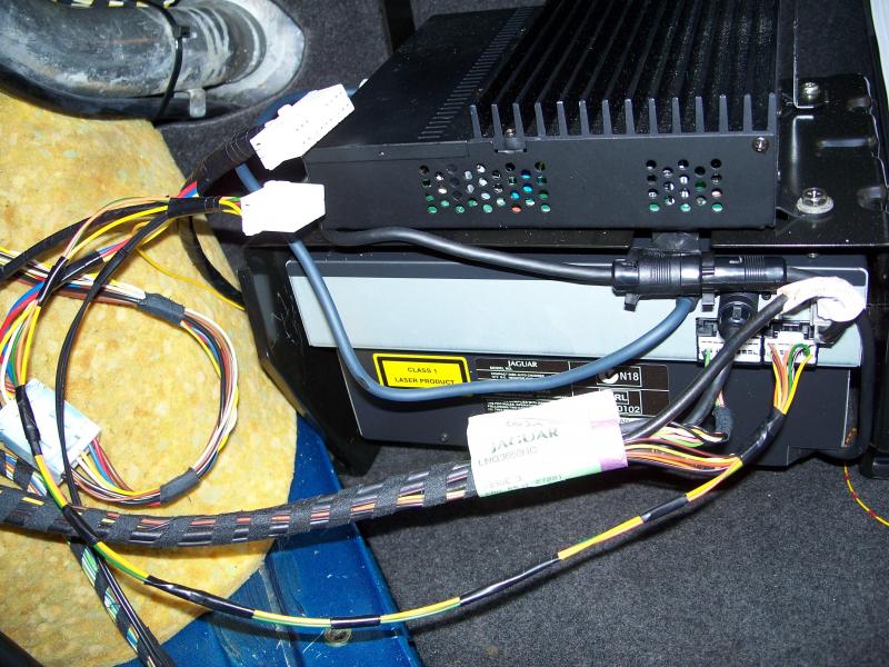

The next photos show the wiring to the rear of the Power Amp/Sat-Nav/CD Autochanger stack-showing the 3 Sat-Nav audio connections on additional new pins (3 required) for the Tyco/Amp Multilock 040 connector on the rear of the Sat-Nav unit. Also shown are the 2 new white plugs & new harness going into the Power Amp-the red, blue, white & yellow subwoofer outputs can be seen exiting from the new speaker harness to connect to the plug on the existing vehicle wiring:
Upgrading the Standard audio system to the Premium system-picture-051.jpg Upgrading the Standard audio system to the Premium system-picture-055.jpg
This next photo shows the completed audio stack with the power plug connected/wired up & the speaker plug connected up, with the harness awaiting extension & routing through to the vehicle interior compartment at the rear seat:

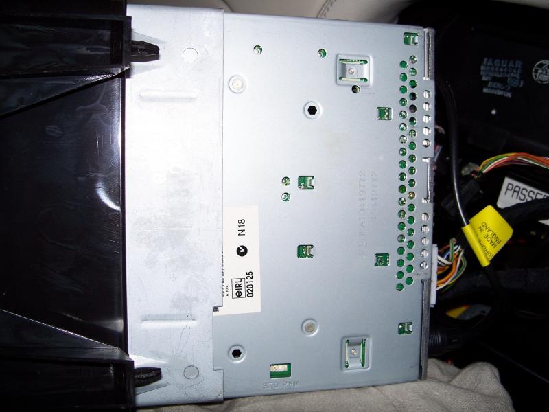

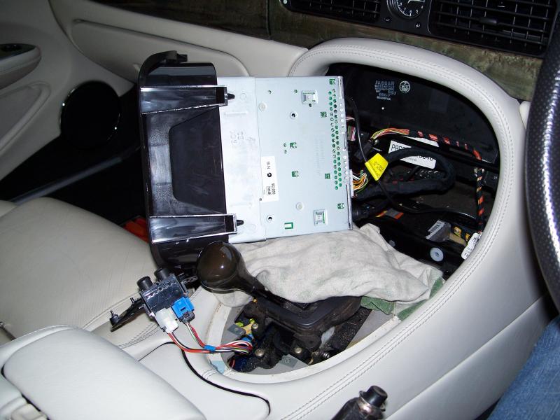

The next problem was to find out why there was no sound from the radio-only the CD. I couldn't find anything wrong with the wiring & installation, so I hazarded a guess that maybe there was some setting on the facia Head Unit. So I removed the Head Unit & located a switch underneath with 2 positions marked 'STD' & 'PRM'. I moved the switch across from the 'STD' position to the 'PRM' position & voila, the radio function worked
The underside of the facia Head Unit is shown in the next 2 photos:
Upgrading the Standard audio system to the Premium system-picture-060.jpg Upgrading the Standard audio system to the Premium system-picture-062.jpg
