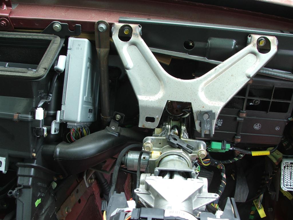

There's the support bracket lowers
and the uppers
If you drop the upper column the uppers can be accessed, maybe even without dropping the column, but I've boned' and built a few so don't look for shortcuts mate

Hi Sean,
Thanks for the pictures. They are a treat as always since almost no one has been
as deep into the vehicle.
I don't think the problem lies in the brackets as the outer column is solid, meaning
without movement, between the upper and lower mounts.
It is somewhere closer to the steering wheel than the face of the upper column
bracket mount. The movement is at most 1/8" vertically at the wheel itself and
you can feel the spring resistance. The plastic shroud can be seen and felt
moving with the wheel while the column beyond stays still. I keep looking at
that bronzish pivot pin in the picture above. Those and the fasteners on
the rear face of that casting are known to wear in other makes.
Maybe I never noticed it before and am just being picky. All my previous
tilt-telescope columns were manual and they use a cam-over locking
mechanism instead of depending on the gears to stay in position.
Do you know what those two adjustment bolts with springs on the outer surface
of the upper column adjust? The 10mm heads face downwards from the alloy cast
tube when the column is in position.
Do any other makes use a column from the same manufacturer?
