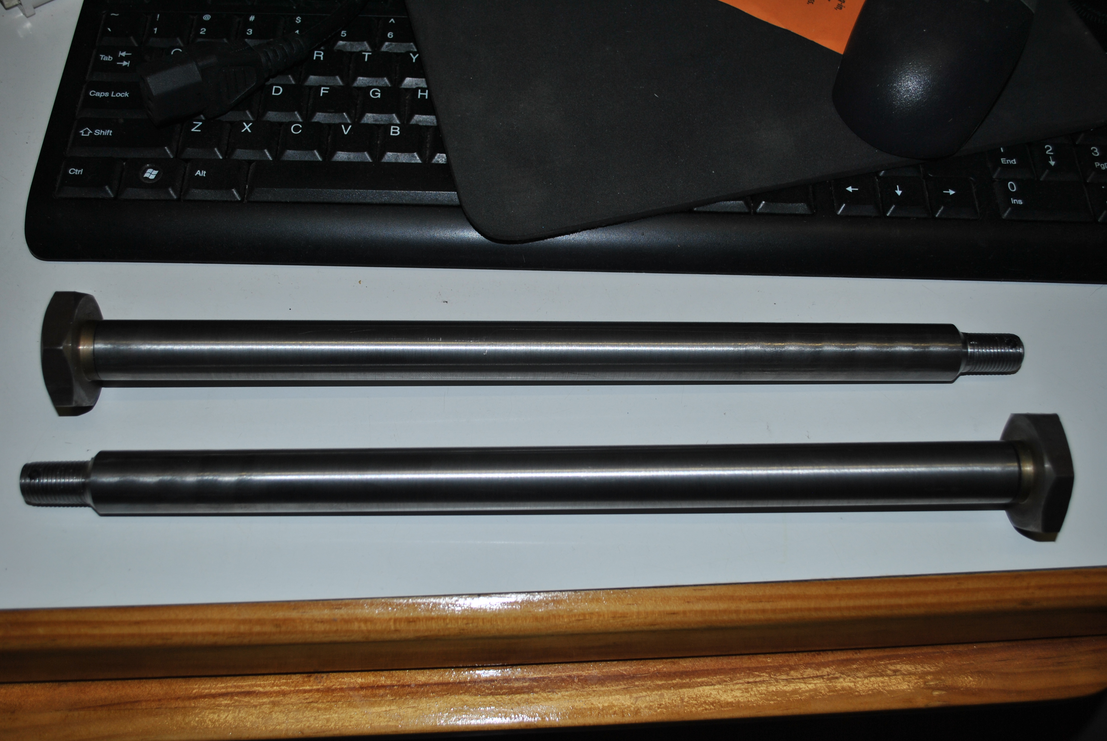

Mine took about 12 hours to do the complete job, every bush and mount was replaced. The wishbone pivot shafts were rusted in the cross member after 40+ years,doubling the time the job took. And the mechanic had to make a spring compressor for the job.
Not all parts fitted are in the picture, some bushes were sourced by the shop as the job progressed.
I was quoted 5 hours by a friend,but ended up paying for 7 hour labour.
Would have done it myself usually, but with the offer of 5 hours labour I had to take it. He had done a few of similar vintage over the years so knew what the job involved.
