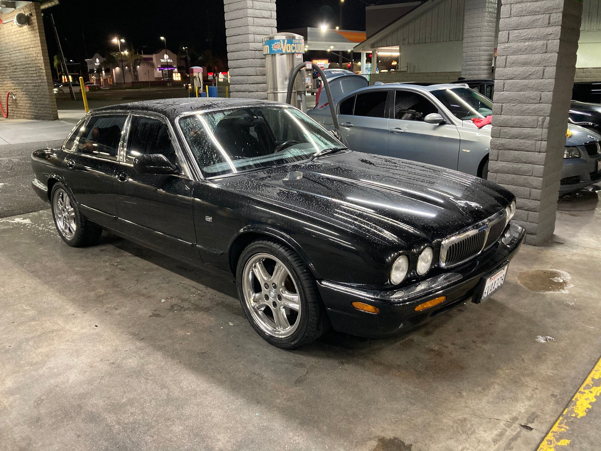

Hey all! New here, I'm 21 and I just bought a 2000 XJ8 Vanden Plas (My first car) and I realized it has a few issues that need fixing but aren't essential for it to work. It's got 99k miles on it and has been VERY well taken care of by the two previous owners. I mean they spent thousands upon thousands on repairs and maintenance. I got it for $4,000 and I really don't know anything about the car just that I really liked the figure and feel of the car so now I'm willing to spend whatever to fix it up. I made a list and hopefully you guys can help me get a solution for every problem listed. Any help would be appreciated. Thanks! 1. Suspension needs to be replaced. I'm not sure if its air suspension or springs, either way I'm not sure where to get the parts
2. Oil change is LONG overdue. (At least I think so, it's at MIN on the rod and is a dark brown color, almost opaque.) What kind of oil can I use and filter? Can I buy it at Walmart?
3. (MY FIRST MAIN CONCERN) A burning plastic scent can be smelled when you rev the car past 3,000 RPMs, or drive above 75 MPH, it stinks really bad and makes driving the car unpleasant. It doesn't smell at under 2,000 RPMs but over that it even starts to smoke a little. The car does not overheat at all.
4. Passenger doors' plastic frame (including everything inside the door. And I mean everything, the plastic door handle, the window button, the speaker, etc etc.) is coming off steel door. Appears to be damaged screws.
5. Rear view mirror has an unclean-able stain and doesn't stay in place. Where can I get a new one, will replacing it damage the electronics inside?
6. Driver door window switch works only sometimes. (This morning it doesn't work at all but makes a purring noise when you push the window down button.)
7. (MY SECOND MAIN CONCERN) Driver door keyhole does not work unless you apply pressure. (It won't turn left unless you apply pressure until it "pops", only then can you unlock it.) I'm scared of breaking the key, or the lock. I can't unlock the car any other way, more on this below.
8. Rear brake light bar does not stay in place. Missing holder.
9. Driver side headlight is burnt out. Where can I get a cheap working replacement?
10. Paint is peeling off in some areas and is super scraped in some areas but not very noticeable. I think it's mostly the clear coat coming off.
11. Car is showing four errors in the message center, TRAC unavailable, ASC unavailable, Low Oil Pressure, and Check Rear Lights.
12. Wiper blade needs to be replaced. I don't know what size to get.
13 Both front doors have air seeping in on the top rear corners of the door. The wind is very loud and takes away the peaceful quietness of the car. Might have something to do with the way the door seals are shaped.
14. Both key fobs do not work, even after replacing the batteries, they do absolutely nothing.
That's all. Like I said, the car is driveable, just not very comfortable or a performing at its best. I will upload photos and videos if requested.

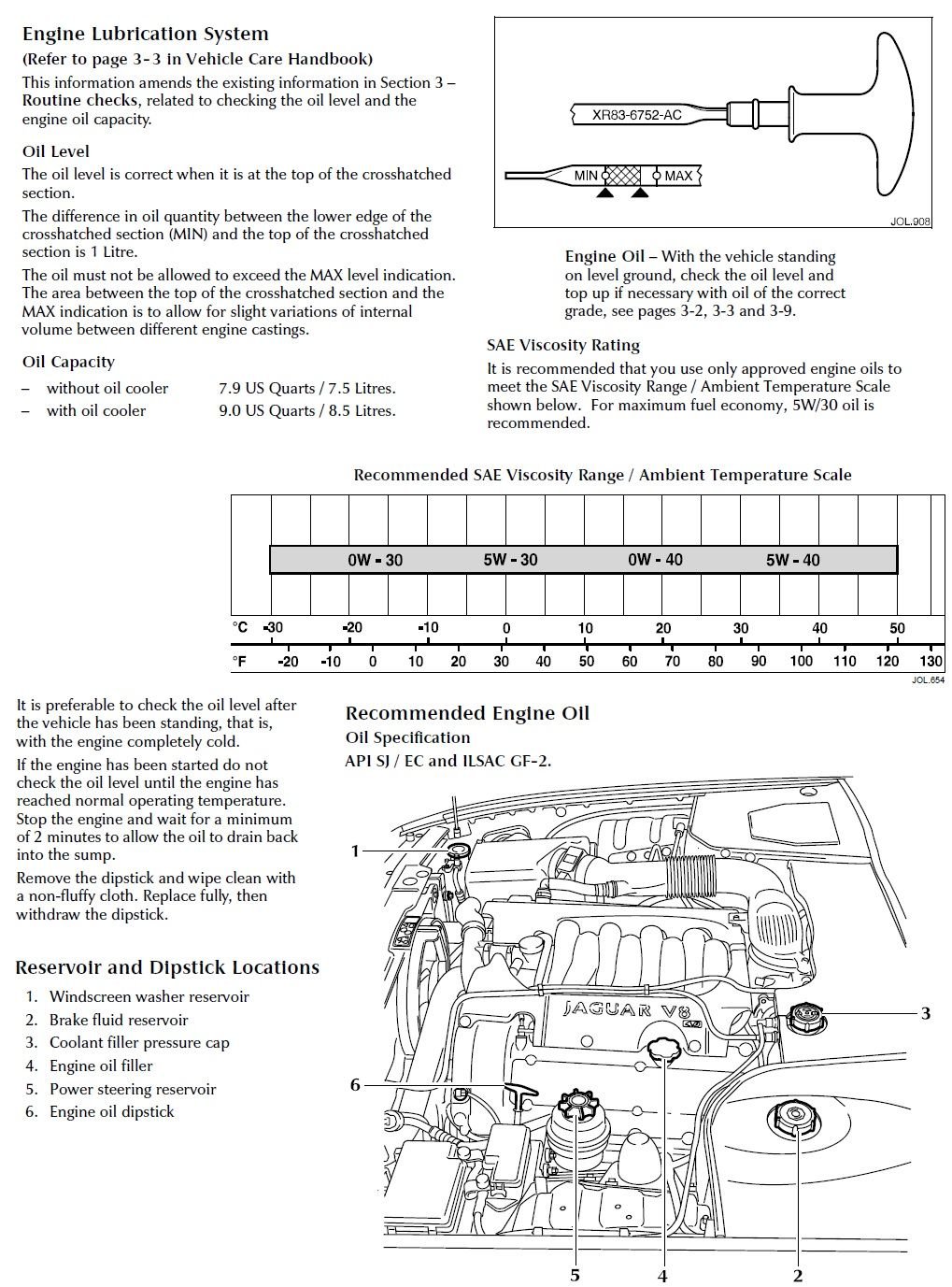

OK, stop driving the car until you at least change the oil. I use mobil1 5w-30 in my XJR, which I think is the factory weight. Its important to use the right weight in an XJ8 as it variable valve timing and I beleive that is working on oil pressure. Go to walmart and buy two 5 quart jugs and a filter. Any brand oil is fine here, but you really need to get some fresh oil in there and the right amount before you bother doing anything further...the low oil pressure warning light is on for a reason and you're talking about burning smells and smoke coming from the car. Don't invest any more money until you can figure out if your engine and transmission are any good.
Old Mar 21, 2023 | 08:39 AM
RA110623's Avatar
Banned
Joined: Mar 2019
Posts: 550
Likes: 103

Thanks Mobile1! I knew I've seen that before but couldn't find it. Great info.
