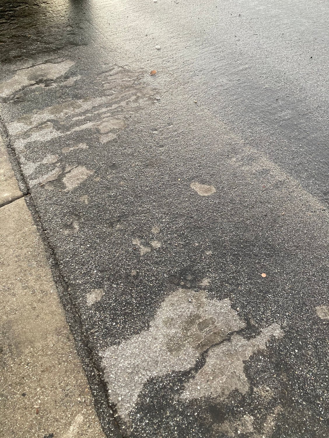

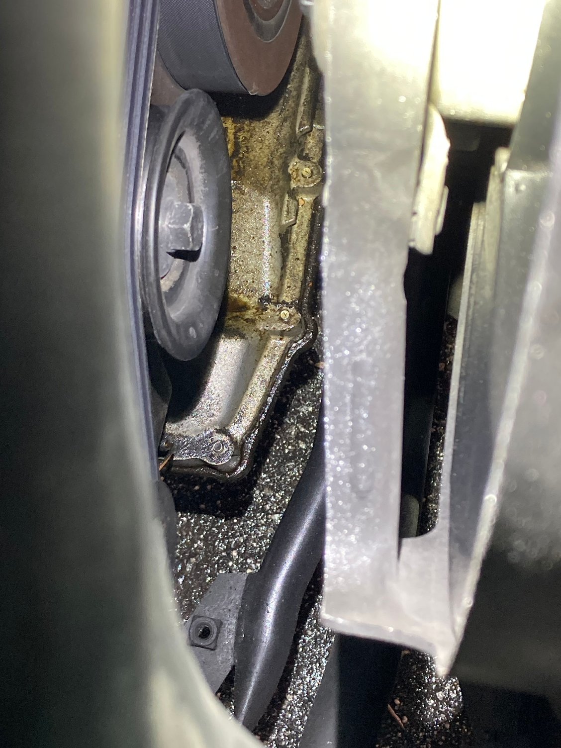

Oil or something has definitely leaked down there.

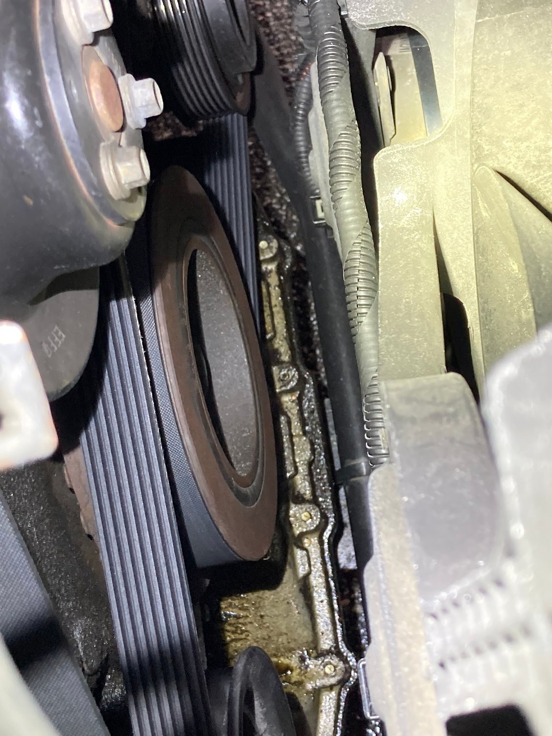

Better view of the leak.

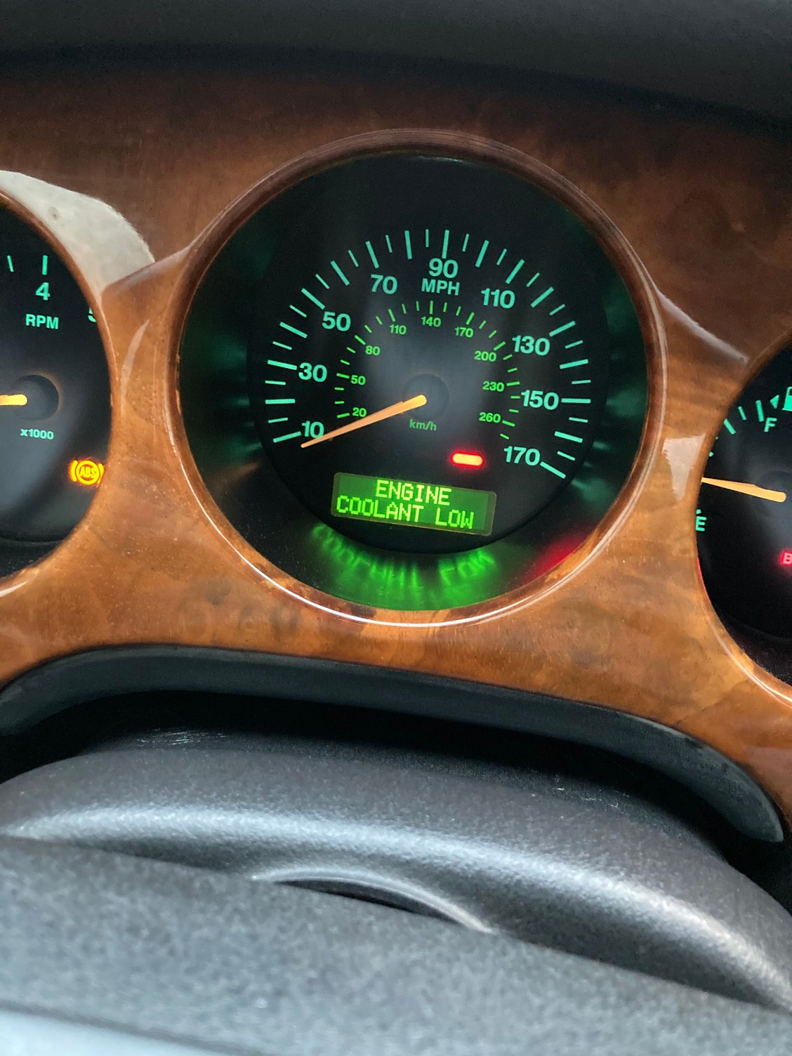

The coolant is low now apparently. It's not by the way.

From the look of it, you may have a bad oil pan gasket or something in that area leaking...maybe the oil pressure sensor or something (which would tie in nicely with the low pressure warning in my mind, but I don't know where that sensor is located...might not be anywhere near there), I don't know whats in the immediate area on the front of the motor. In the first video its hard not to notice what looks like a pretty significant pool of oil on the ground coming from under the car by the left front tire (1:16)...did you spill something there or is that from the car leaking?
Low coolant you could have a bad sensor, or an air bubble trapped in the system. When cold, open the overflow bottle and see whats inside...make sure to check for evidence of oil in the coolant as that can indicate a head gasket problem. My 01 threw a low coolant light at me, the bottle was about half full, so I just filled it up to the top and let it overflow to find its right level, haven't had an issue since, maybe you'll be lucky there. Also try burping the system to get any possible air pockets out, with the overflow open and the engine cold, squeeze the larger diameter coolant hoses to force fluid to move around the system...any air should work its way out to the overflow bottle and the level in the bottle will drop, then you top it off again.

4. The oil on the top of the upper pan. Could be valve/timing covers, crank seals, VVT seals, etc. I would clean this up and check it after a drive if you can see oil accumulating again.
