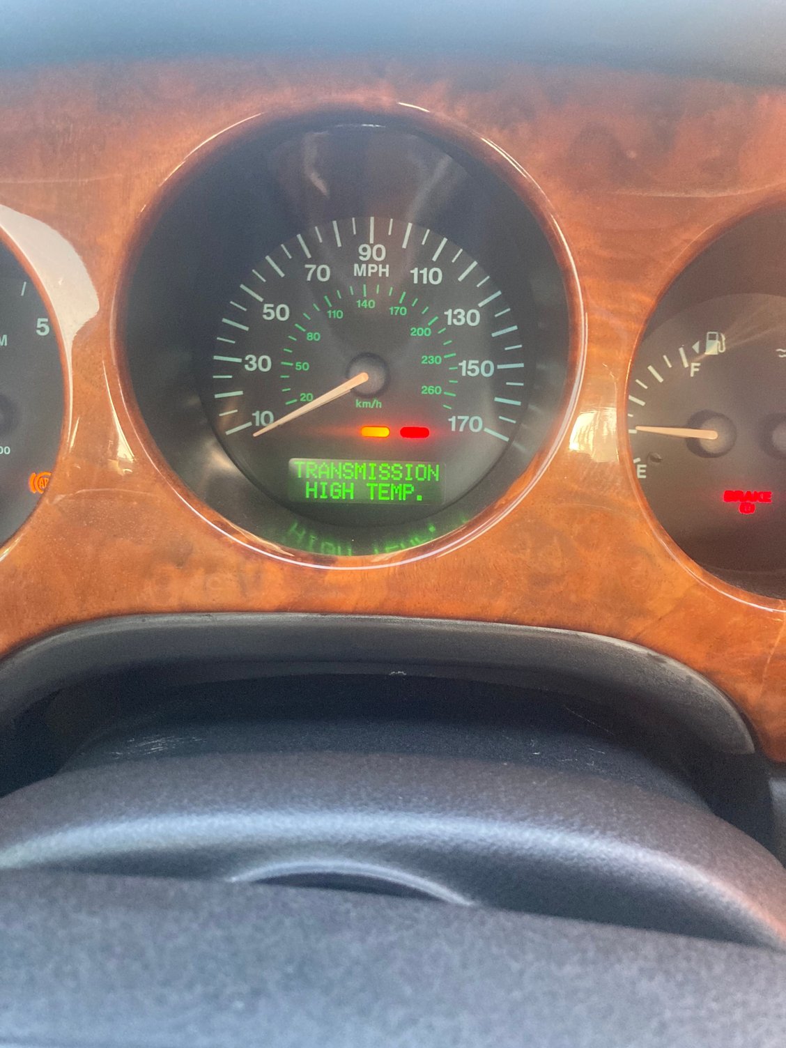

Uh oh guys, this isn't good news is it. Just powered it on and the car went from 1.5k RPMS down to 500rpms in about 10 seconds, then "low oil pressure" "transmission high temp".
The car is losing power on startup. This happened after I swapped out the air filter. It's a cold start by the way. It acts as if it was warm already instantly but it's not. It hasnt been powered on since yesterday.
Update: I just opened the air filter case and closed it tightly and the high temp transmission message went away, however, the sudden loss of power remains.

Eric, given the car has been parked outside and not driven, it’s not good news but might not be bad news. To start if you don’t yet have a code reader so you don’t have to rely on the car’s messaging, you should. Make sure it can read Jaguar codes but they’re pretty inexpensive. You should also buy an inexpensive volt meter so you can check the state of the battery - these beasts are full of demanding/sensitive electronics and anything less than a good battery in good shape can play havoc. Sometimes a “hard reset” as alreadysuggested above can also clear some codes.

Yes I believe it has something to do with the battery actually, as yesterday it wasnt doing this. I noticed when revving the headlights dim a bit and so does the power in the car. I believe that little noise behind the dash, whatever it is, is draining the battery. I will buy a voltage meter first thing tomorrow morning and let you know what it reads. Thanks for everything Ken!

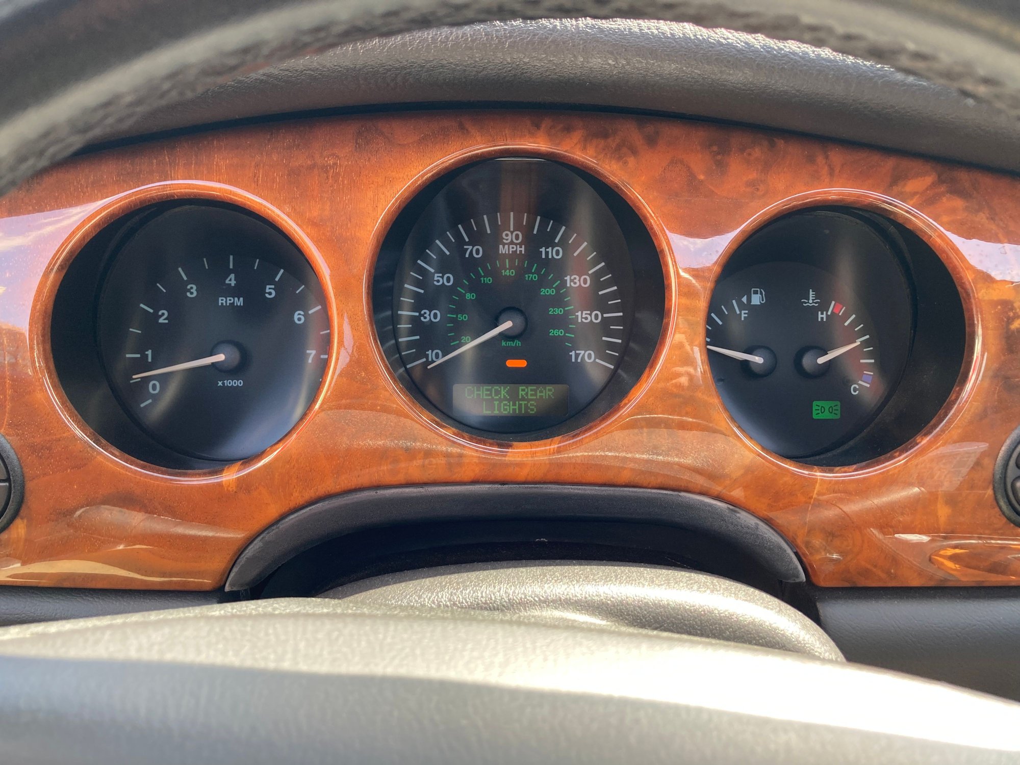

Eric: first, thanks for the photos and videos….the car is not nearly as bad as you described! I have owned a lot of Jaguars, an X308 included, and nothing I saw or heard on the videos alarmed me.
I strongly suspect that you have one underlying problem: the battery!
Random warning lights are a known symptom of insufficient battery voltage, as are random failures in the electrical components. You have been given a lot of valid advice, but I would urge you to first put in a new, fully charged battery. Let me repeat: fully charged! Next, do a general servicing as has been suggested: oil, filters, etc. That done, you will be able to properly and calmly assess the overall condition.
Check the fuses for inoperative systems: the left hand headlights….
finally, I repeat that nothing I have seen or heard scares me. Not far down the road, however, is the replacement of timing chains and tensioners, a quite “normal” bit of one-time servicing on this model.
Overall, this is a very attractive car, well worth bringing up to standard.

Eric, those who have responded to your queries do so because they want to help you. As for me, my long experience with Jaguars has taught me that seemingly complicated issues very often have a simple source.
So I can only repeat this: a very, very likely source of at least some of the issues is your battery! If the battery is more than 4 years old, or if you do not know its age, it is best to replace it with a NEW, FULLY CHARGED battery.
While I suspect that ensuring a constant full voltage will eliminate most if not all of those pesky warning lights, it will not obviate replacement of all fluids, lubrication of locks, etc.
