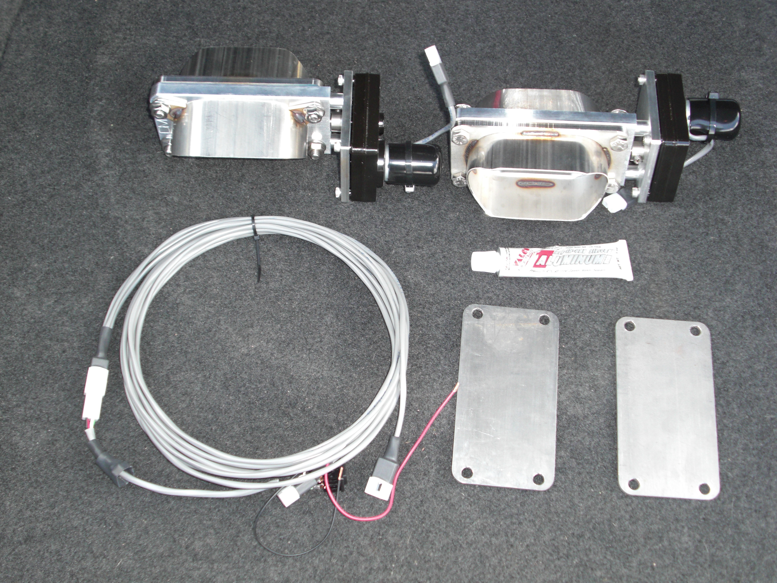

Originally Posted by Highhorse
Since then, I've decided I'm going to go with cutouts like Vector.
Nothing like it!
Vector
Attached Thumbnails V8 Growl desperately needed-10-motors.jpg   V8 Growl desperately needed-1-box.jpg

Vector, that's awesome work sir !
