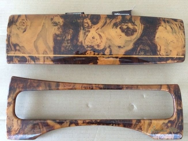

I think have a few dark wood door pieces that were in great condition. If still looking I'll check. I have a few pieces posted in classifieds for sale but have some other darker ones laying around I'll look for.
The VDP door wood trim have a gold line running down them, similar to a pinstripe. The center console and airbag pieces have lines with letters.
Here is a quick example:
