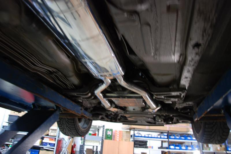

Some pictures taken at the garage:
Attached Thumbnails Very happy with Quaife LSD + extra power-dsc_0568.jpg   Very happy with Quaife LSD + extra power-dsc_0565.jpg   Very happy with Quaife LSD + extra power-dsc_0567.jpg   Very happy with Quaife LSD + extra power-dsc_0566.jpg   Very happy with Quaife LSD + extra power-dsc_0564.jpg

Looks nice. My car is a sponsor car for Buckhead imports and we are making our own set of headers. I'll let you know volume level when its done. My car won't have cats though. With my previous mods it dyno'd 379rwhp on a dyno jet. Ported supercharger is a good idea, i ran one of those for a little bit. I hesitate to speculate on a finish date for my car as ALL of the parts are custom and it's become a MONSTER of a build. we just got finished with pistons, sleeves, connecting rods and also drilled out the head bolts to accept a larger stud. I had a killer copper core head gasket made too. Compresion was also lowered half a degree as the supercharger that we are fitting to it is a big one so we can run plenty of boost. I looked into quafe but I ended up changing the gear ratio to 3.55 and adding Mercedes benz SLR Blue shift solenoids (you can do the solenoids on your car fairly easily and inexpensively) i hear they make a big difference. What are you doing for your intake? Factory airbox? I was running 18-19psi (almost too much in my opinion) when i had both upper and lower pulleys. I hear there is an ex. ford guy that is able to tune ECU's i'm sure he's still working on tunes and I'm excited that he can do it so we have options outside of Eurotek.

p.s. what kind of exhaust system is that. That resonator is MASSIVE!!

What brand are those catalytic converters and what pipe size are you using?

They come from eajp.com .
The resonator looks much bigger(longer) in this picture than it really is. Should take another pic.
