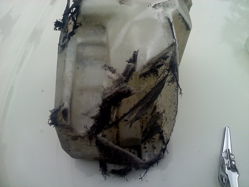

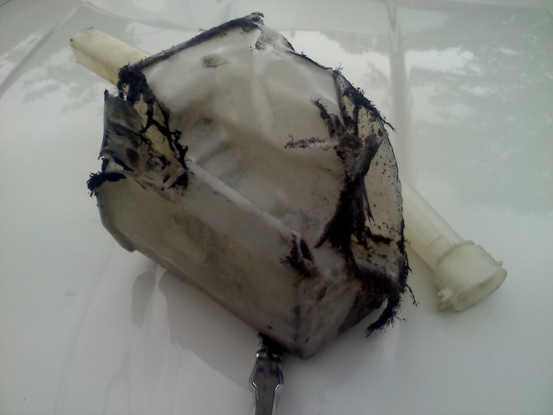

Hit a major dip in the road then heard a crunch I kept on, heard a scrub. Pulled over to see washer fluid streaming from under car, container hanging a inch from ground. Tried to semi-secure it up higher to no avail. Drove it half a mile to home lost the bottom half of reservoir. Since my nozzle was already out now I guess I'll tackle both @ once.
Anyone know what I'll need to secure a new one in place and also I seen some wiring attached was frayed to the copper. Links & diagrams would be much appreciated.
Did I mention this was directly after a dentist appointment lol. Upon closer inspection this has happened before as the under apron was scraped & frayed.
Anyone know the fuse for the windshield washer reserve pump as I don't want any current going through those frayed wires.
Thanks in advance.

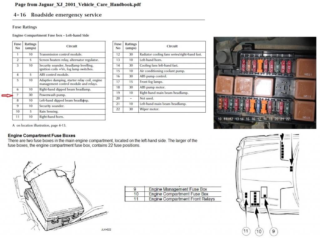

My book shows fuse number 7 engine bay fuse box as the power wash fuse. BUT that is for UK spec 98 XJR, so may not be the same as yours. You may be 3000 odd miles away on the other side of the Atlantic, but the councils seem to have the same agenda on fixing the roads. It really gets up my nose to see 2 men pull up to a pothole in a van, one then gets out and paints a blue line around it and then they drive off !!! Why not put some cold lay tarmac in the hole ?

Old Jun 3, 2014 | 06:48 AM
jimlombardi's Avatar
Posts: 2,636
Likes: 1,636
From: Southington CT
Jim Lombardi
Attached Thumbnails Washer fluid reservoir fatality grrr,-2001xjenginecompartmentfusebox_zps8c33c87a.jpg
Old Jun 4, 2014 | 02:08 AM
King Charles's Avatar
Posts: 4,513
Likes: 1,030
From: North Carolina,USA
Thanks as I don't want any current going through frayed wiring.

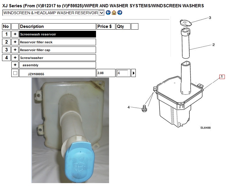

Old Jul 16, 2014 | 09:50 AM
Posts: 2,636
Likes: 1,636
The windshield washer reservoir is installed by removing the RH wheelarch liner, then removing front undertray, then position reservoir (below and up through welded mounting plate located in front of and below air cleaner box) aligning with BIW holes and fit and tighten the four securing bolts.
To get a larger view of the following images (in the JPEG files)
Just click on the image
or
Right click on image, then take "Open link in new tab" option. Then open the new tab and view the enlarged image.
Here is a JPEG file showing the parts list for the components of the reservoir:
Washer fluid reservoir fatality grrr,-jaguar-xj-x308-winshield-washer-reservoir-info.jpg
Here is a photo of the reservoir installed through the welded mounting plate:
Washer fluid reservoir fatality grrr,-xj-windsheild-washer-reservour-mount.jpg
