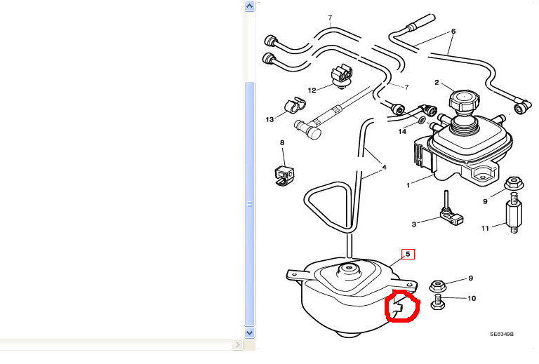

Ups, had the same problem as you describe just on my way to a mountain resort. I was driving for about 3 hours without any problems. Then I stopped at a gas station to refill. Just seconds after I turned off the engine, coolant fluid started to leak under the front left side of the engine... First I thought it was the plastic radiator cap (the one for draining the system) but when I touched it - it was dry. Then I disassembled the shield over the front left wheel and found the expansion tank. The coolant was leaking from there.
My main question is - should I have some kind of cap or plug on the expansion tank?! Because when I checked it there was just a whole on it (maybe this is some kind of overflow vent to prevent high pressure) and while the engine was working - no coolant was leaking. After turning the engine off it starts running antifreeze from this whole... and every time it's loosing about 1.5 liters of coolant.
Please give me some advices on how to fix this because right now I stuck in a cabin - 200km from the nearest civilization
P.S> I just had a look at the EPC... it seems that this is just a whole... but then - why the coolant is leaking from there?! The only two things on this expansion tank is the hose entering in it and this strange whole!

My bad I decided to read the entire thread once again and even when I was absolutely sure that all my hoses were connected properly to the header tank I went down to the garage (thanks god the mountain cabin we are at has a garage) and noticed that the two pipes are not crossed as described in the thread...
Maybe I did this mistake after I had my cooling system flush last week...
Well I disconnected them and reattached back the hoses crossed. I hope this is the reason why the car was "bleeding" it's coolant. We'll see tomorrow morning as it's getting dark, cold and snowy outside and I'm not sure if I want to make a test run right now.
I made a photo after switching the hoses - please, tell me if they should be connected this way!

Correct, you can also confirm that on your previous post image for the routing of the pipes and the crossover effect.

Yes that is correct -- the upper one above the first cap seal is the overflow.
the pic of the bumper overflow tank you have circled in red, is that suppoed to be just an open hole?
