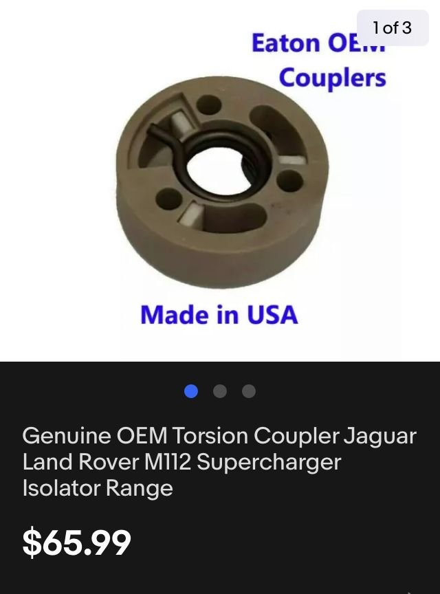

The first thing you should do is remove the supercharger belt and start the engine. The engine will run and drive fine without it on. If the noise goes away, chances are it’s just the coupler and won’t require a press to replace it. The second thing is do you know if the secondary tensioners have been replaced? That could also make a clacking noise. How many miles on it?
On eBay.
This is the only supercharger coupler you’ll want to buy. DO NOT buy those cheap solid couplers as they sound like you have marbles rolling around inside the charger after you were chasing a noise to begin with and now it’s worse. Ask me how I and many other on here know. Don’t forget the oil and the red non-curing liquid gasket maker.

Well! What super helpful advice!!! The car is a 2003 with 156K and I do not know if the tensioners have been replaced or not. I will be removing the valve covers while I have the manifold off and will check on them, Good advice on the coupler too! I hope that is all it is. I'll let you know I hope today what I find while the belt is removed.
