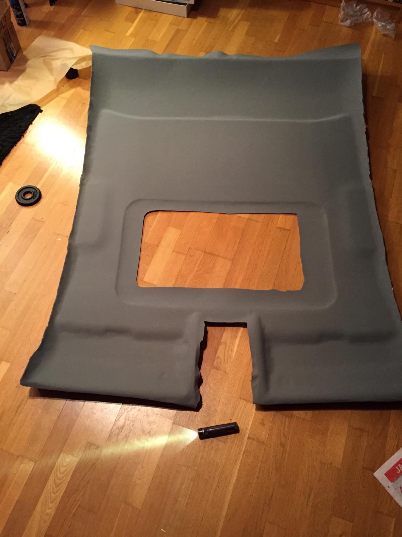

Recovered headliner board and sunroof with new fabric

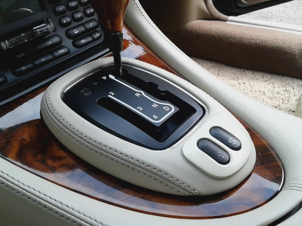

One of the very few things I did not like on my VDP was the plastic shift cover.
It looked cheap because of the material and its yellowish color.
Sourced a leather version from one of the forum members.
Color was oatmeal, but after some preparation and some ivory leather dye, the leather turned out a factory fit.
Then spray-painted the switch-cover, and re-did all missing mounting pins in an other way.
Very happy with the result.

Originally Posted by ericjansen
Still playing cassettes I see?
I should get a few and try them in my XJR just for nostalgia!

Ericjansen- If you could tell more about replacing missing pins...I am suffering the same problem...Also would like the leather wrapped shift cover rather than the plastic. I have tried to glue the pins back in..not working very well.
Let me try to explain as I failed to make pictures:
The newly purchased cover came with several of the white plastic grommets, which are normally located on the base plate, and are holding the pins down.
I separated the "stainless" surround from the leather cover, and used this as a base to create new pins.
This surround has already holes which allow the original pins going through.
I then used these little grommets to glue in the holes of the surround (if I remember well, with the flange up).
After hardening, you can cut the excessive plastic, then glue the old broken pins (or anything which can act as a pin) into these grommets.
Finally, I clipped and glued the stainless surround back in the leather surround (after all dye-work done).
Check if it a clear fit before you glue it, I remember I had to cut some plastic away where the old pins were broken off.
After that, you will have a surround which has very sturdy pins, and can be installed in exact the same way as the original, by pushing it into the original grommets on the base plate.
You can remove it any time by just pushing the surround up.
I hope this is a bit clear, not easy to describe in text, but probably rather easy if you see the parts.
Will make some pic if needed.
Vector
We just moved back from 15 years living in Mainland China to the Island, and during the extensive moving-cleanup, I found several tapes which went all around the world with me in the last 30 years.
With finally a car which actually has a tape player, it is all a trip down memory lane from there .. highly recommendable!
