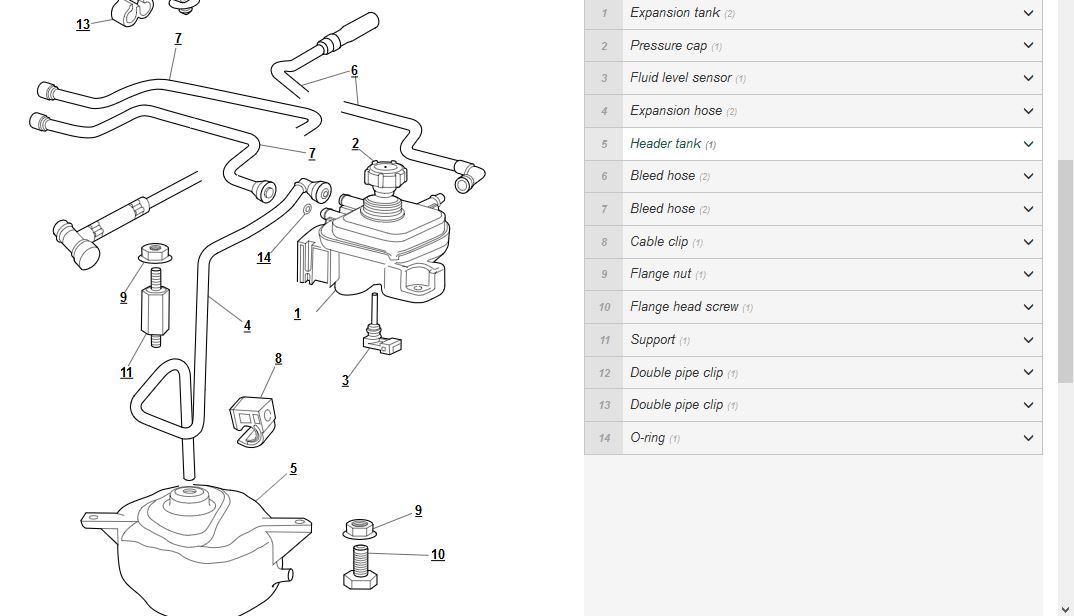

hello guys. just a question I always fill the overflow tank but in my other car it has radiator cap so is my 2002 xj8 has radiator cap ? or it's just overflow tank to fill and that's all ?
thank you .

The cap on the tank next to the firewall is the fill point for the cooling system. The overflow tank is located inside the wheel well at the front of the vehicle.
Item 1 is the expansion tank. item 2 is the pressure cap and item 5 is the overflow tank.
I didn't find it thank you for this picture but honestly I don't know how to find it . can you please show me real picture
thanks for the help

Mobile,
There is no "radiator" cap per se.
Coolant is added to the system via the expansion tank (item #1 in avern's diagram) by unscrewing the expansion tank cap (item #2 in avern's diagram).
Hose #4 leads to the overflow tank (#5) which is located (hidden) under the front bumper and is not needed to be readily accessible.

Originally Posted by Carnival Kid
Mobile,
oops I thought that's the recovery tank I always fill this and check it . thanks for help
