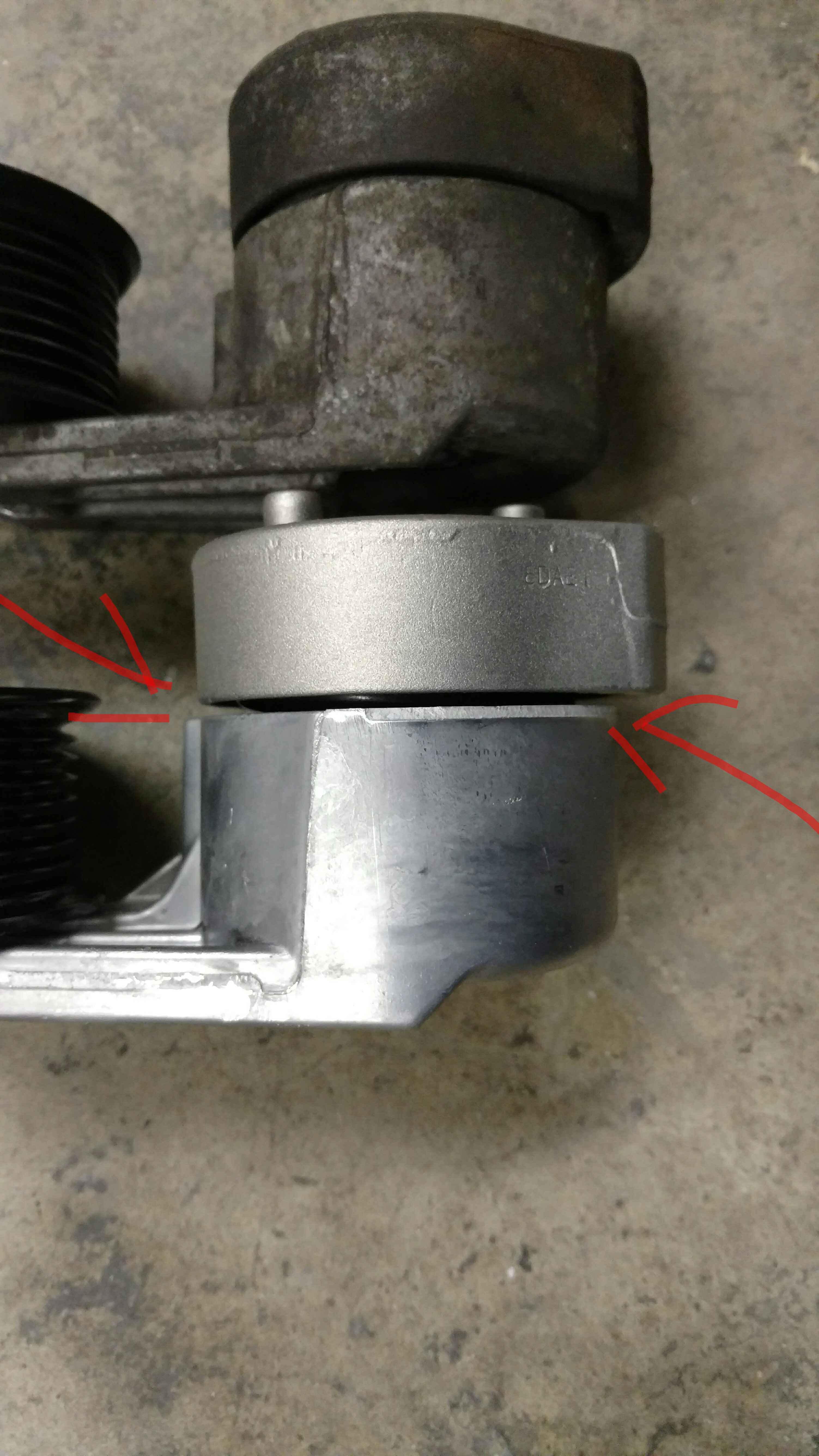

Most "tricks" will work for a while but return.
Usually it's the tensioner itself being worn at its pivot. Not the bearing.
You can see in these pics. The space between the moving part of the tensioner and the base that mounts to the engine. The old one is wider on one side. The new is same both sides. So picture that idler going off on an angle causing misalignment of the pulley. The belt ribs side load and cause noise when entering or leaving the pulley.

Thanks a lot for all comments and pics..what a great forum this is 👍🏻...I need to look more into any misalignments and consider buying new ones.
