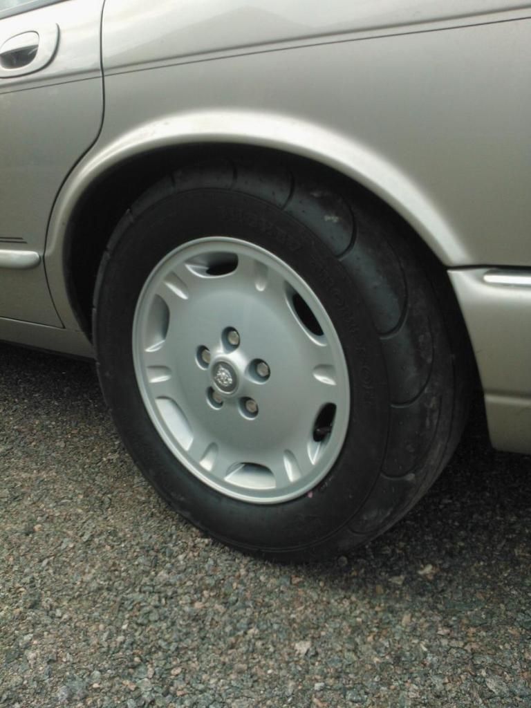

I have 255/50/16 drag radials on orginal 7inch rear wheels.
The fact that it fits does not make it technically correct, 255 is considered too wide for a 7J rim
Old Aug 30, 2020 | 05:02 AM
XJR-99's Avatar
Joined: Nov 2011
Posts: 878
Likes: 324
From: Europe
Since they are drag radials with soft sidewalls min is 7 inch wheels. Using normal tires - 8 inches.
Old Aug 30, 2020 | 11:27 PM
ericjansen's Avatar
Joined: Dec 2013
Posts: 3,256
Likes: 1,371
From: Taiwan, R.O.C.
I saw that, and yuo are perfectly fine with that.
The reason I mentioned this is that for the less technically challenged here on this forum, your advice might be read that 255 is ok to fit on a 16x7J rim, which is not.
