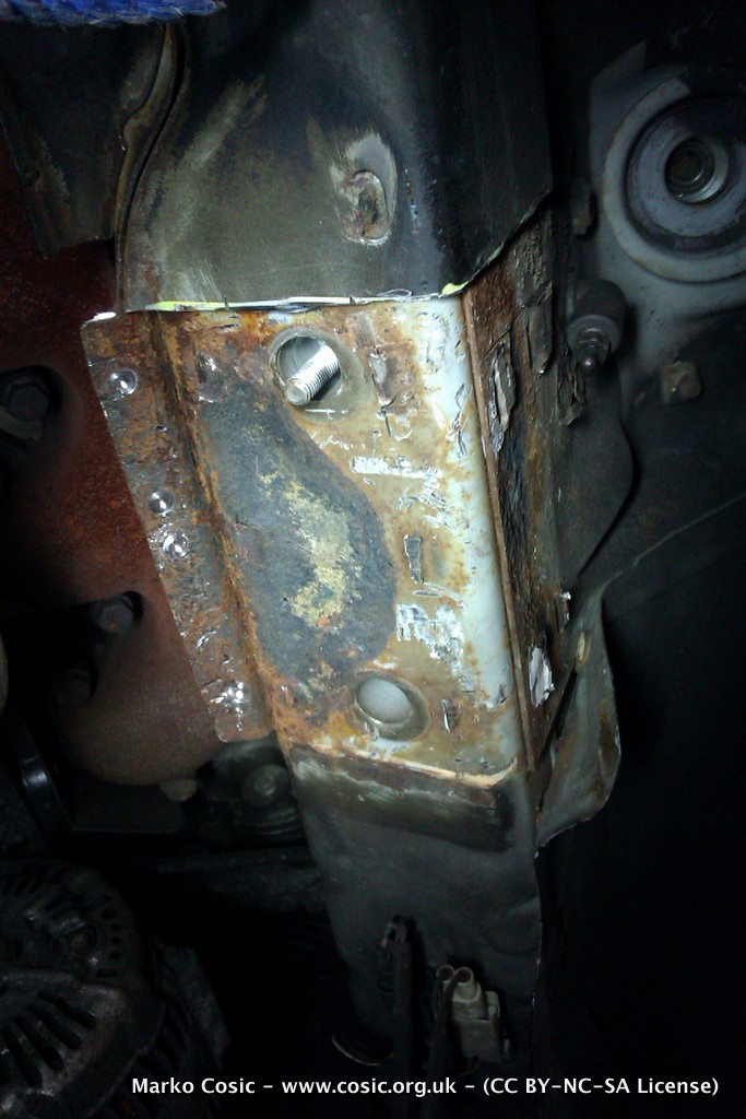

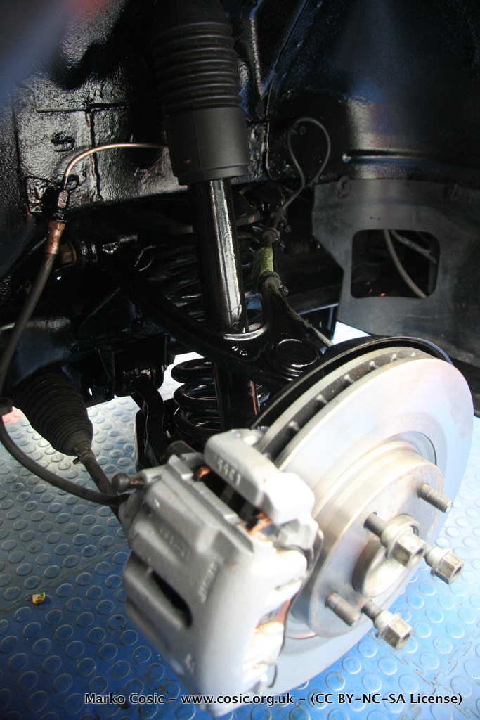

Hi folks,
I'm finally putting together the "build memoirs" for the X308 Phaeton, and thought that some of these chassis leg repair photos might be helpful:
X308 Phaeton – Bodyshell Repairs |
Fixes this kind of thing...
Marko
Attached Thumbnails X308 chassis leg repair-03-img_4049.jpg   X308 chassis leg repair-07-img_4096.jpg

Sorry to be thick, but could you put an arrow on one of those "plug welds"?

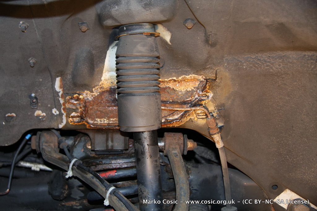

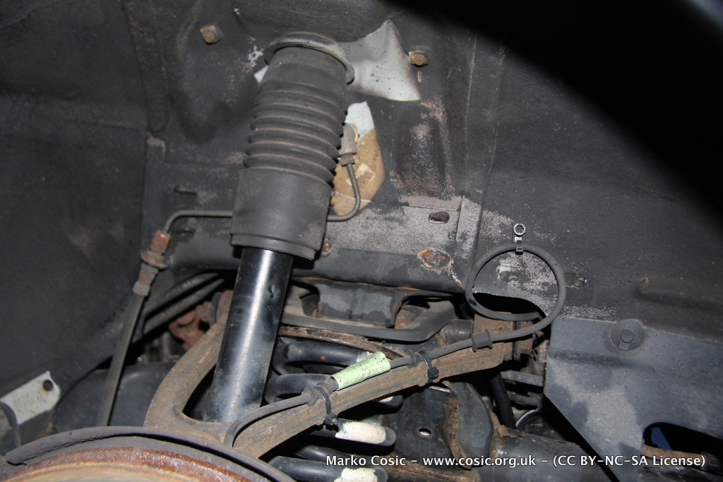

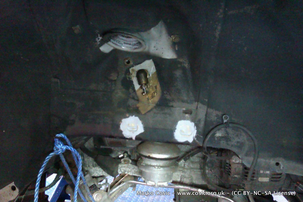

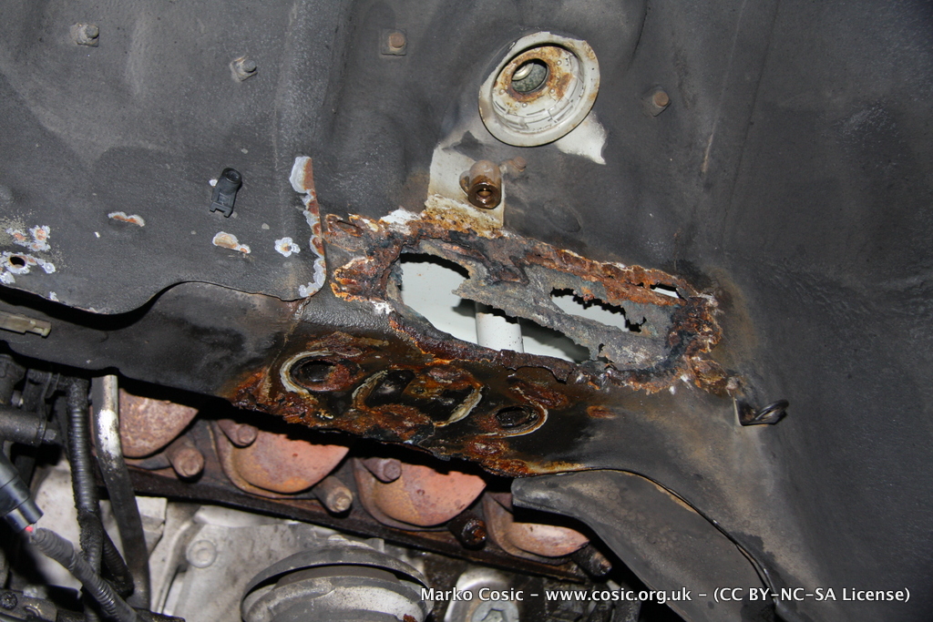

I've added some shots of the SuperV8 plums, as the OEM plug welds were obliterated by rot on the 1997 car. Highlighted in the second photo here.
Looks ok?
Prepared for access:
Outer layer removed:
Finished repair:
