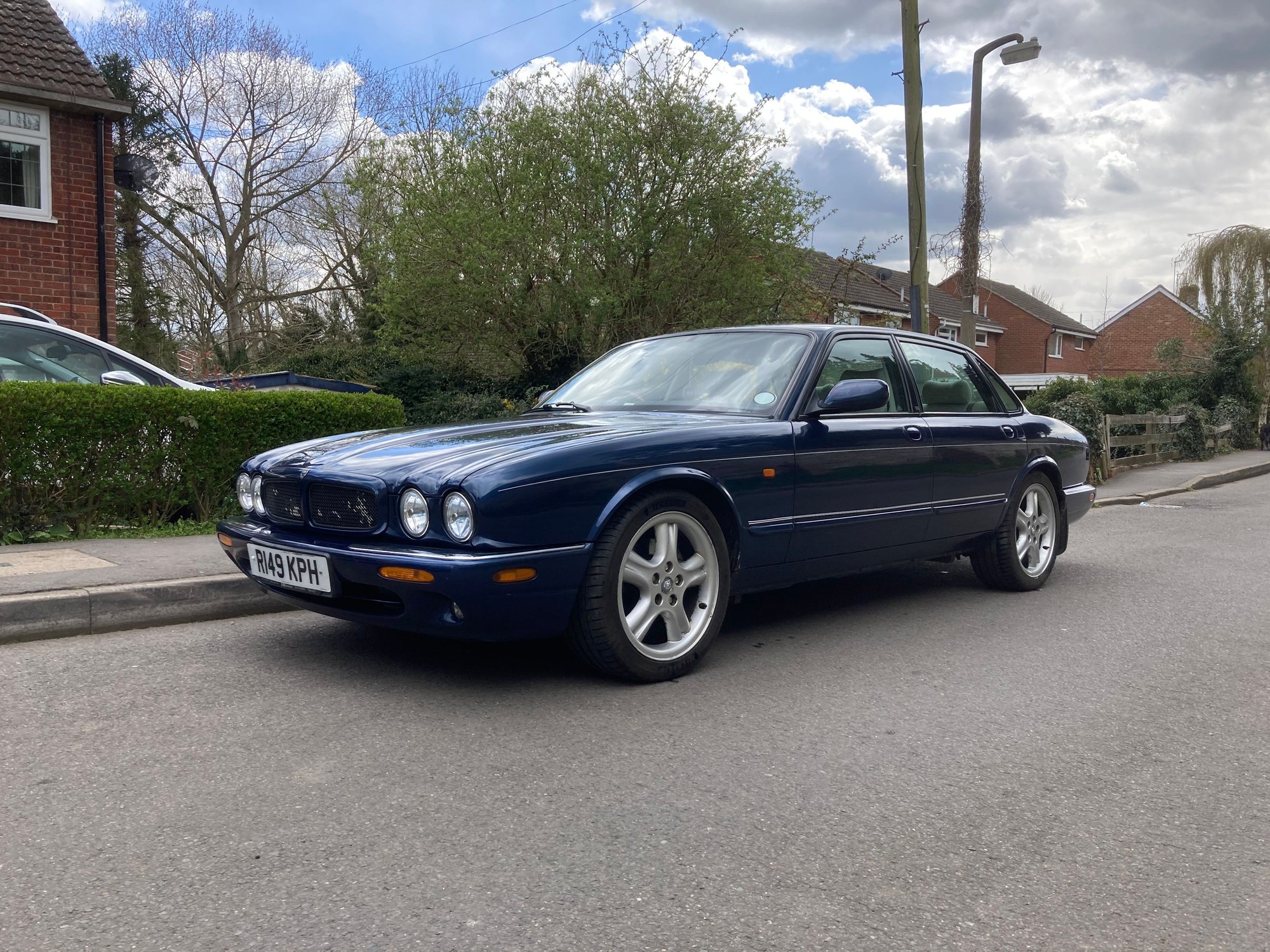

This is how I bought the car. Barely fitted on the trailer. But I was one happy customer!

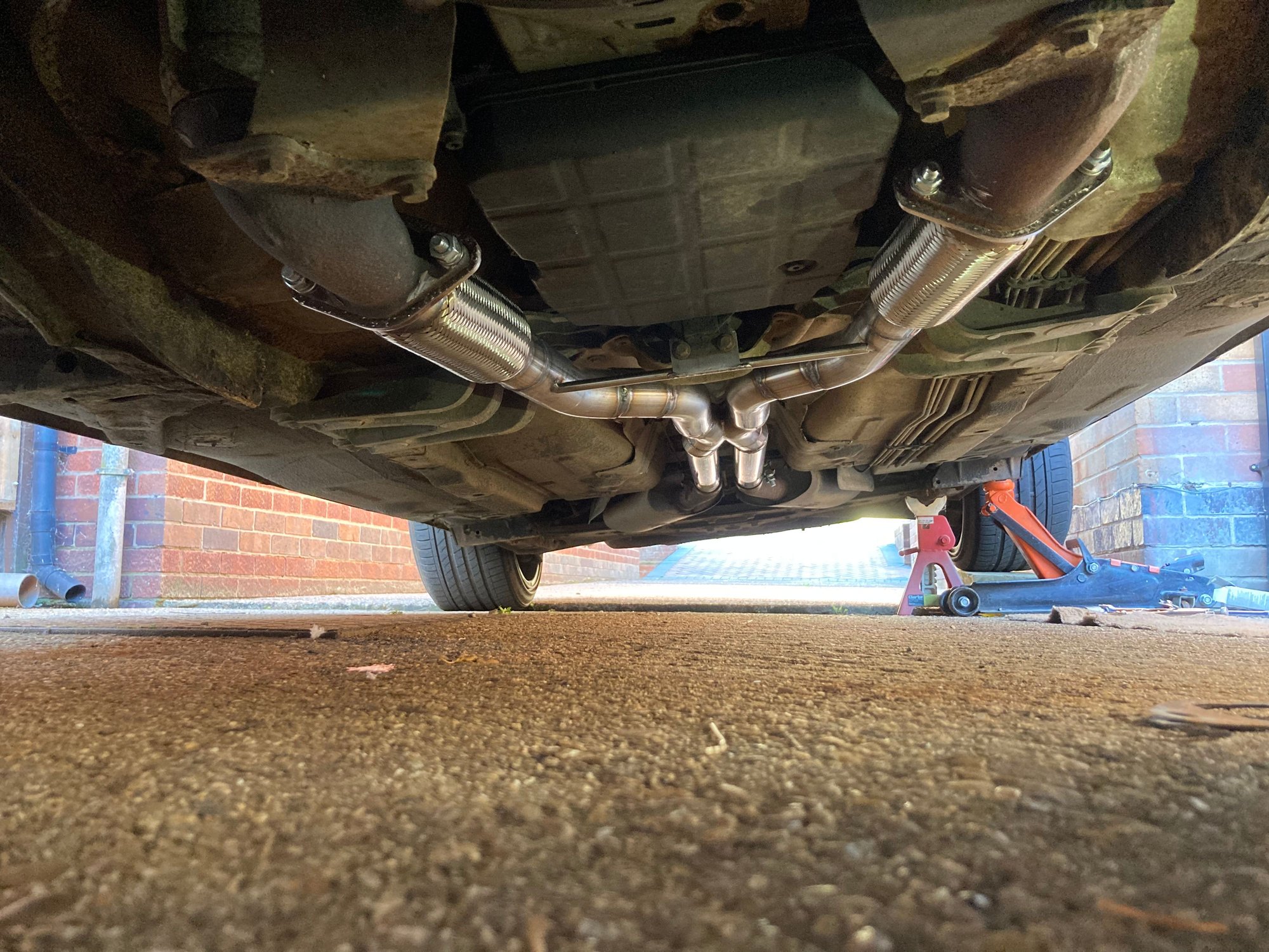

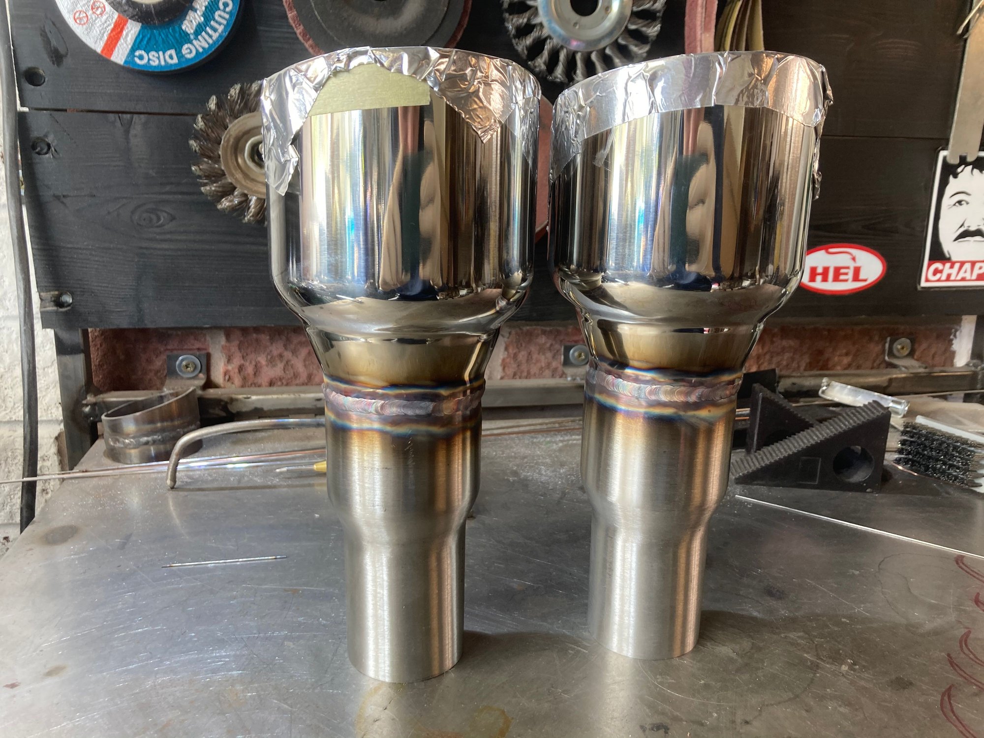

The standard exhaust was far too quiet so I made a start on some rear silencer deletes with a 4” tail pipe finisher
Here is the finished example of the rear silencer delete.
The view of the new tail pipes on the car.

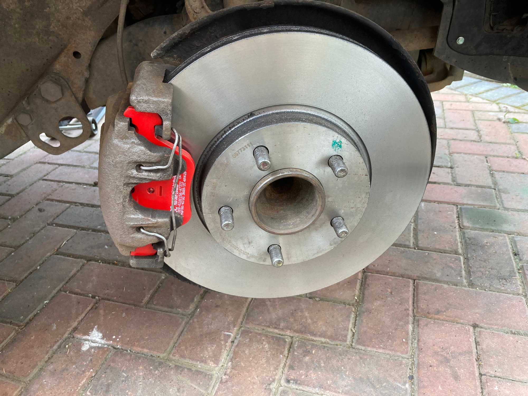

Some fresh disks and pads EBC red for a bit of extra bite.

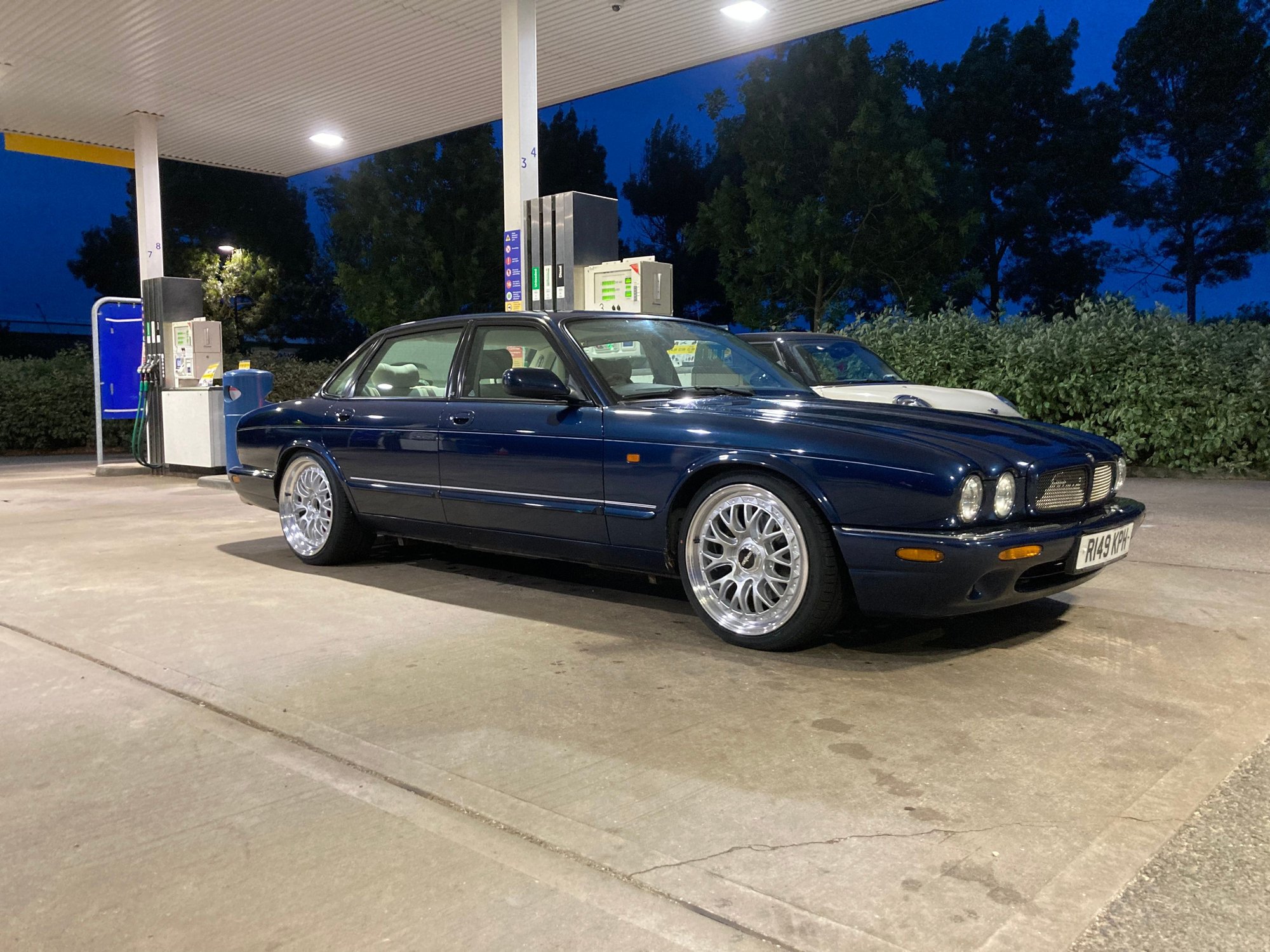

Some rotiform wheels and a little lowering to get the stance where I wanted it.

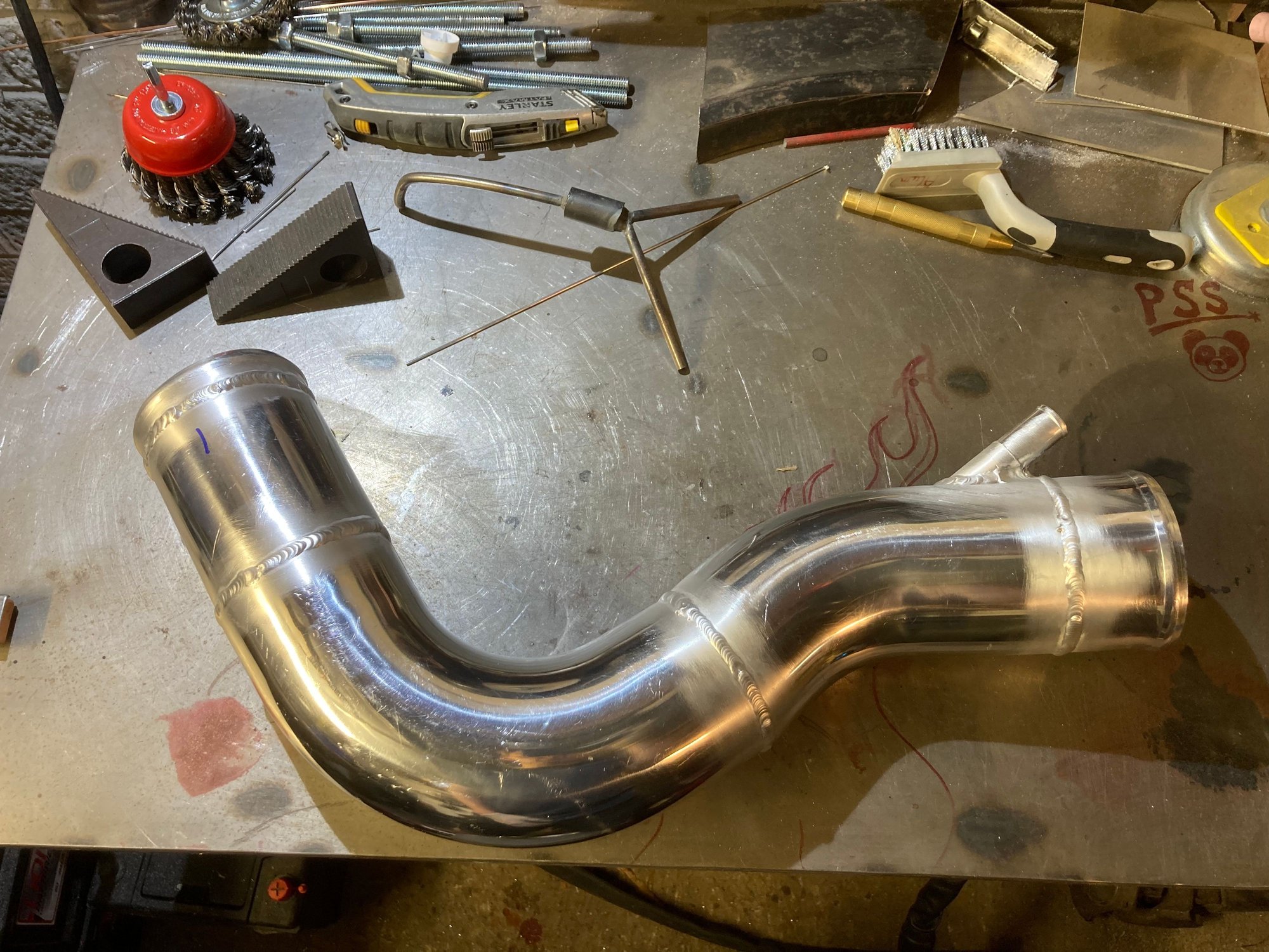

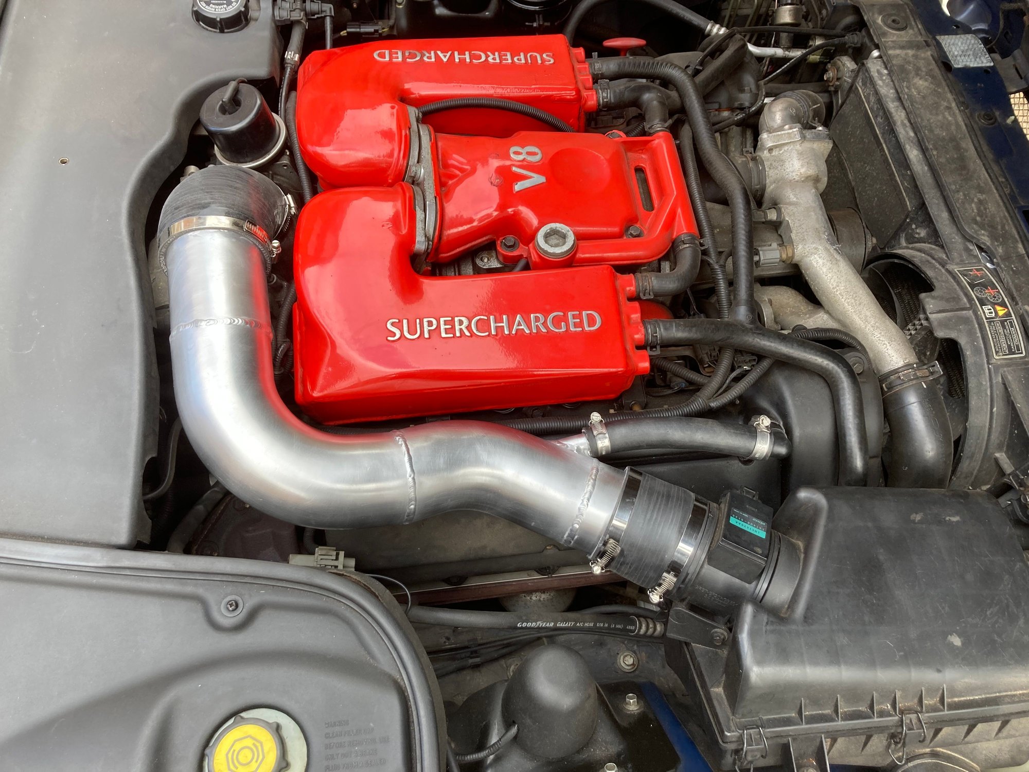

Wanted a little more supercharger noise, so made a start on the aluminium intake.
Here is the finished and fitted part. A slight increase in supercharger noise, better throttle response and better pickup at the top of the RPM range. Overall very happy with it. Looking forward to hearing it with an uprated supercharger pulley.

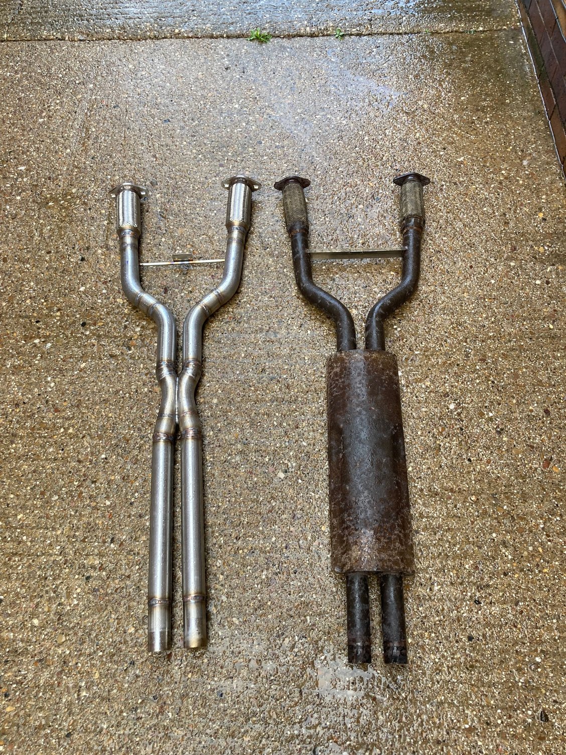

The car was still too quiet for my liking, even with the rear silencers deleted plus the original part was starting to fall apart. So I set about making an X-Pipe resonator delete.
Here it is fitted to the vehicle. In my opinion it sounds much nicer. Still not overly loud but closer to that of modern performance vehicles. Think AMG Mercedes or modern Range Rover sport.

Nice. Was the parts store out of 6” tailpipe finishers?

clean work. not to my taste maybe on the exhaust tips and loud exhaust, but you do a nice job. Particularly that intake tubing. Is that a 3.5"? Any hood clearance issues?

It is a 3" intake, had to make it oval at the throttle body end so that it does not catch the bonnet. I have since redesigned the future intakes to get it lower and further away from the bonnet.
The next X pipe I make will have some small resonators in it to remove the slight drone you get with a resonator delete at 1800-2000rpm. I have invested in some slip rolls so will be able to make the resonators fit with the rest of the system.

If you want more rumble without the drone and not obnoxiously loud you put the X pipe where the large single front muffler is, straight pipe the two center mufflers and leave the factory rearmost mufflers alone.
