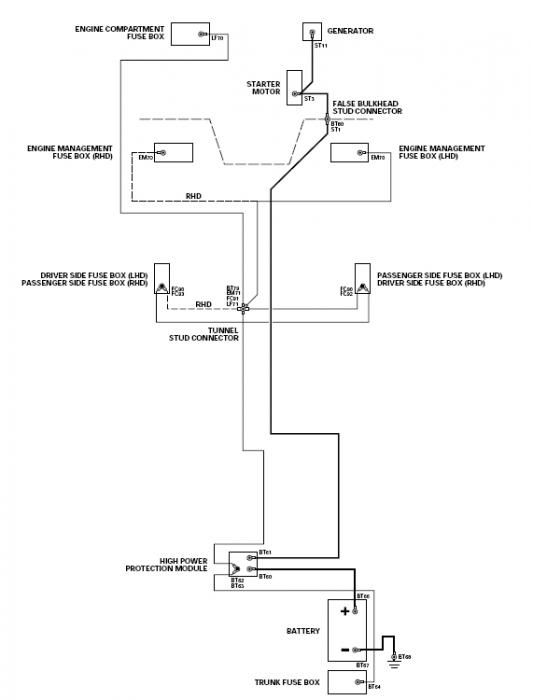

I have power to interior, radio, locks and such...When I turn the key I get nothing , no sound no clicking, Ive have checked numerous relay they are good, now I'm cleaning all grounding points to ensure a good ground. Does someone have a good wiring diagram? Thanks

First get a history on the car to see if in fact it was a flood car. If it is walk away! If you are comfortable that it is not a flood car your next step is to get the car to crank the engine. Once you get to that point investigating the real problem if you have one. I hope this helps!
Attached Thumbnails XJ8 Electric Issue!!!-97powerdist.jpg   XJ8 Electric Issue!!!-highpowerprotectionmodule.jpg   XJ8 Electric Issue!!!-starter-aj27-n-.jpg

Gus,
Thanks I can't see the attachments, I'm working now to get the engine to crank, I'm cleaning all the grounding points now. Battery is good and has full charge...
