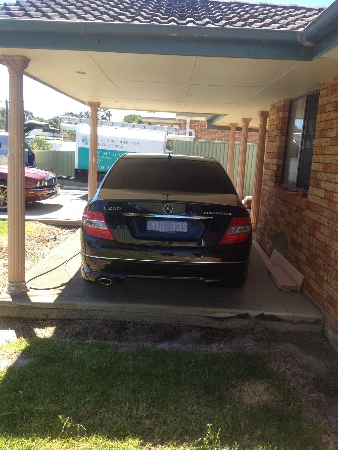

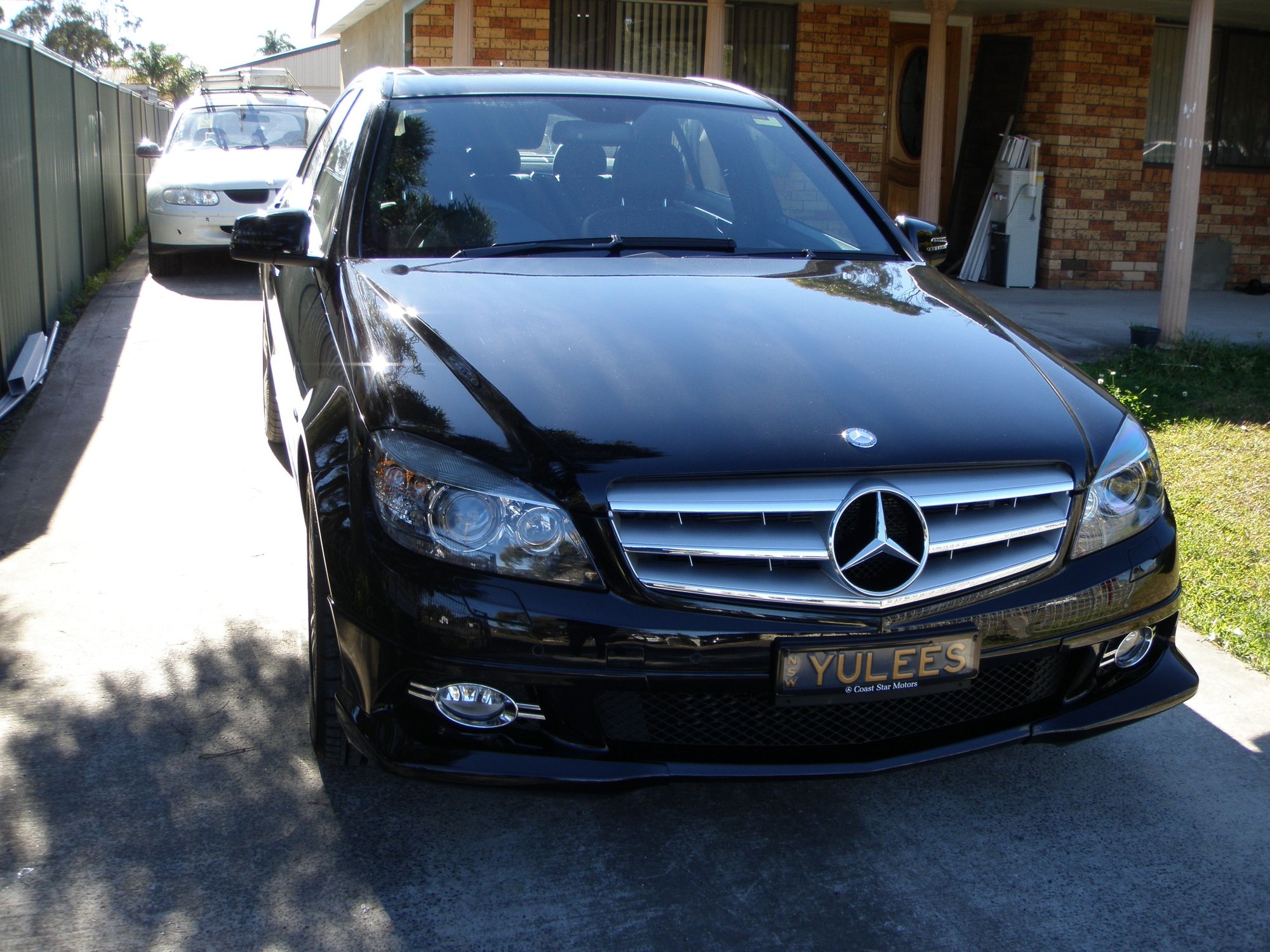

Tired of your old Merc, they will give it a new look

Unbelievable must be a lot of fiberglasses to make them look like a Rolls
kazakhstanian get your eyes off my Merc
They might make it look like a Rolls but its still a Merc

Well, if you really like Rolls, that thing is an Blasphemy!!!
