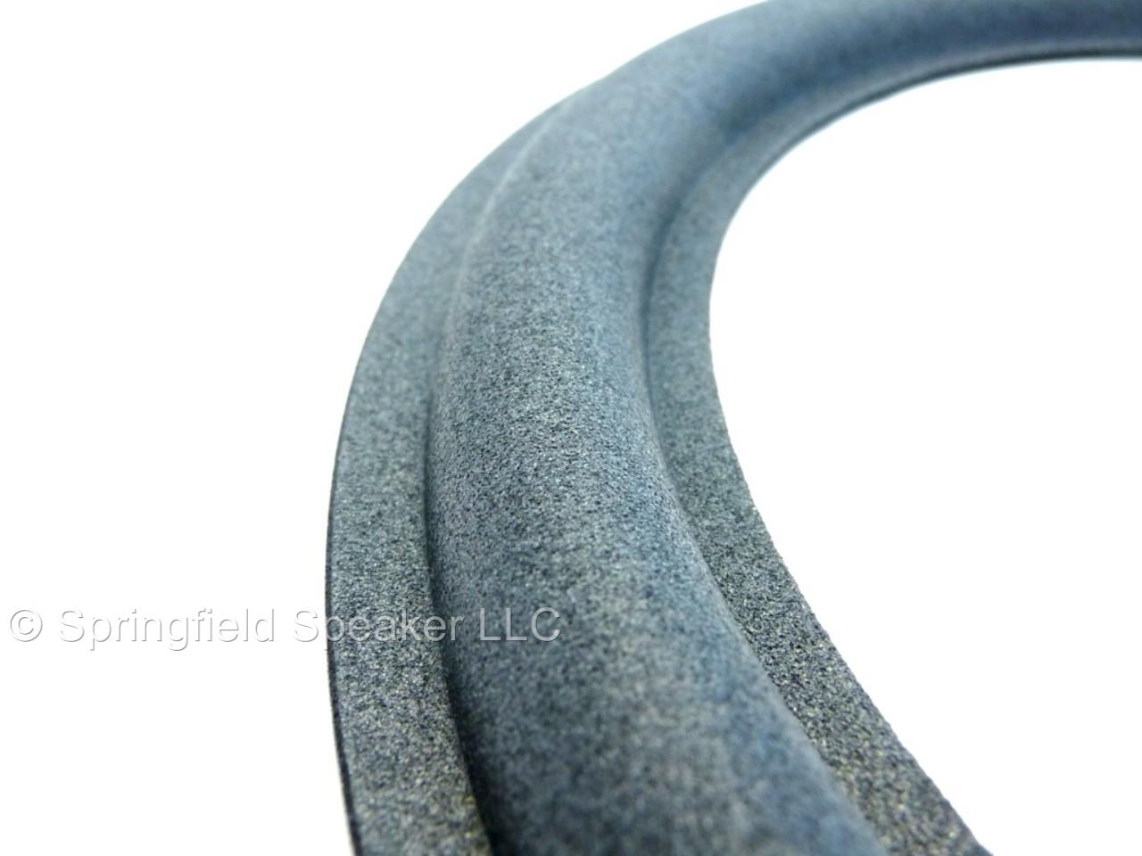

My 2003 X308 has the Premium Alpine speakers and is now experiencing some problems. Driving down the highway, the radio was playing great and all of a sudden with no warning at all, it started sounding terrible. All the bass was distorted and even trying to isolate the subwoofer by turning it down to -7 (the lowest setting) did not seem to help much. After much tinkering, and isolating the different speakers by the fade and balance settings, I have determined that even the door speakers do not sound that great. I have no idea what to do next to try to fix the problem.
You sound as though you might have experience with these systems so you might have a course of action.

First you must check visual if the surround speaker are broke, i will attach two photos to identify quickly what type of surround you have on those speakers.
You have two choices: to replace the speakers with the normal one from a broken XJ or to repair the existing speakers in a special repair shops. They can order for you the right surround an replace it. In Romania is cheap about 10 usd for one speakers but this process take a lot of time an laborious work so i do not know how much you will pay for this job.
A broken XJ8 might be very close to the same issue, so the repaire option looks like the best choice..
