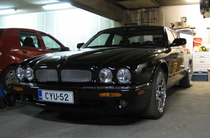

Any car + summer tyres = not a snow car We have ice/snow here most of the time from November till March, so I've driven on snow a lot.
I have 225/50-18 studded winter tyres on my XJR. It's actually my first rwd car, and no probs in the snow so far. Traction control is a bit too eager to "help", and it needs to be turned off is something special like acceleration is required... lol
These tyres do look awfully narrow on it though...

JKO is in the right part of the world to know about driving in winter conditions.
Like it or not, winter is a long season in Western Canada as well.
In my experience, the XJR is a good snow car.... but I found some 16" BMW steel wheels that would clear the Brembo brakes on the XJR. I fitted them with 225/55/16 Snow tires to match the spec diameter of the stock wheels. They provide a significantly narrower footprint than the stock wheels. The added 2 inches of sidewall profile also helps (and makes for a much nicer ride as well). The important key is to use snow tires... not all- season tires. The rubber compound hardens in cold temperatures much more with summer and all-season tires. Winter tires are made with a rubber compound that performs much better in cold temperatures. This allows you to stop much sooner even on relatively dry roads in cold spells. JKO goes to the extent of studded tires, but many places outlaw studs now, as they are hard on dry pavement, especially with a car like an XJR that can rip a patch of asphalt out on demand. Studs are great on ice if you can get them.
With the setup I described above, My XJR was superior to the front wheel drive van my wife drove in the past. No question, her current 4x4 SUV is better than the XJR in deep snow. If you need to drive an XJ in winter conditions, you will find the above formula transforms it into a better than average snow car. I have gradually evolved into using the traction control system 95% of the time. The first winter or two, I shut it off, but in deep snow, it actually works better. I have to climb a hill to my garage and now know that traction control gets me there better. Slow but sure, vs spinning the back wheels. If you have to stop on a hill, you may need to switch it off, but with some forward momentum, the traction control seems to do its job. Obviously, it will prevent you from ripping around and spinning donuts, so for that behaviour, one must defeat it.
I would say the biggest drawback to the XJR in snow, is that since it is pretty low to the ground, you sometimes end up plowing snow if you have more than a foot of fresh stuff. Nevertheless, it plows pretty good!
Low profile, summer tires in northern climates should be illegal during winter months in my opinion. (Not that I like regulations)

JWT, you're quite right about the smaller footprint and higher profile tyres. That's the configuration I've used on my previous cars in the winter, and I'm actually on the look for 17" XJ8 wheels for next winter. I'm not yet sure whether to stay with studded tyres or not. I haven't used them in the past 4 years actually, but these came with the car (almost new). They are rather noisy at low speeds on asphalt, but superior on ice of course.
BTW, it's mandatory to use winter tyres between November and March here in Finland, and most ppl use studded ones.
