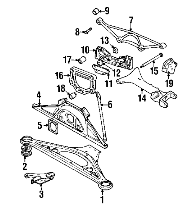

If your running OEM wheel tire combos for both models, you will get way more roll from the standard XJ8 with it's taller sidewall (225/60) and narrower 8.5" wheel which is made for comfort. Any VDP-R (mine) or XJ Sport with performance wheel and tire combo (I run 245/45 Michelin Pilot Sport SS on Penta wheels) with a much more rigid sidewall with minor roll and wider 10" wheel, the tire rides more flush with the pavement.
Those tires differences plus with whichever suspension you have make a world of difference. I also don't have a rear sway bar, I have the truss setup (#7) or as Jag calls it Bushed Differential Strut and I have CATS. I can definitely tell the difference when my CATS is on or off. Also, mine weighs 132lbs more being a VDP and 5" longer, so your 160lbs less drive line weight would make some difference. Base XJ8 3946.00 lbs, XJ8L 3988.00 lbs, VDP 4010.00 lbs, VDP-R 4079.00 lbs. The lengths of these obviously determine the turning radius, XJ8 19.80', L 20.40', VDP 20.40', VDP-R 20.40'.
