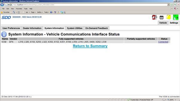

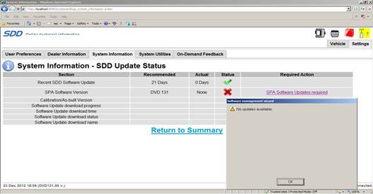

Hi Plums, You're spot on! The SPA_DVD131_V2 Calibration file munched away all afternoon, but the crash happened before this, and during an earlier JLR V130 install. You're also correct concerning the option to go legacy IDS after manually entering the VIN. However, the splash screen pops up for a couple of seconds, as though the programme was loading then 'nothing' the slash screen closes and you're back to square one..

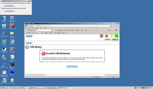

FYI, If I enter the VIN of a later 2005 XJ I can proceed to the next stage which is requesting the Ignition switch to be turned to Position 2 without being asked for any username or password. And connection to the internet is available.

Try rebooting between each step of the install.
Be aware that the failed muppets who designed the software packaging do a couple of nasties during install. eg. silently removing McAfee Privacy if found. It's junk, but still ... dirty pool to uninstall software without notice. And instead of telling you to turn off tabbed browsing, they set a machine policy to disable tabbed browsing for all users. They *could* record the setting before launch, change to the required setting during operation and restore the previous setting on exit. But that would be far too complicated for their little pea sized brains to comprehend or implement even on a good day.
Oh, and do not install to any other path except the default. They offer you a choice, but it won't work because they forgot to update the hard coded path in some components. The space requirement on c: is closer to 12GB and not the 8GB quoted because they forgot to account for the space required for the data crunch. The muppets can't add either.
In general, the entire thing is a disaster in terms of software design. But it is the officially annointed crapware.

I'm not being defeatist here but I'm not prepared to waste any more valuable life on installing / uninstalling / reinstalling different versions of JLR software onto different laptops (Win 2000, Win XP Pro SP3, Win 7). On each version regardless of the OS I can only get as far entering the VIN, then being informed that symptom maps are not available for this car or I've entered an invalid VIN, and on some occasions seeing the IDS Legacy splash-screen popup for a couple of seconds then 'a big fat nothing'
On one occasion, I did far enough into the program by entering a made up VIN (which would have possibly suited a 2005 XJR) and I was able to view some of the tabs. One of them 'System Information' listed a summary of supported vehicles and clearly the X308 is omitted from the list. I must therefore assume I have wasted a significant amount of time trying to get the VCM to talk to a 99XJR!
