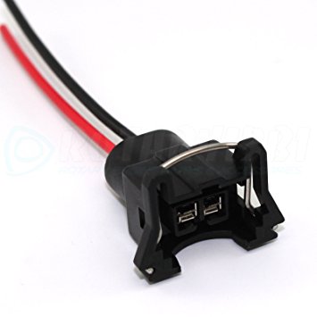

Without seeing the connector is it a EV1 in the pic below ? If so they are easy to find online for purchase .

Sadly not. It's one of these.

it's called an Augat 1.6 3-way connector in the electrical manual. Unfortunately that doesn't come up with much on google, but it's a start, and you know the pin dia is 1.6mm, with 3 pins, so that should narrow down search by a lot. I searched a bit with no luck, I'd try looking for sites dedicated to automotive connectors, maybe cross manufacturer in case ford or someone else uses the same connector, and try to find it that way.
