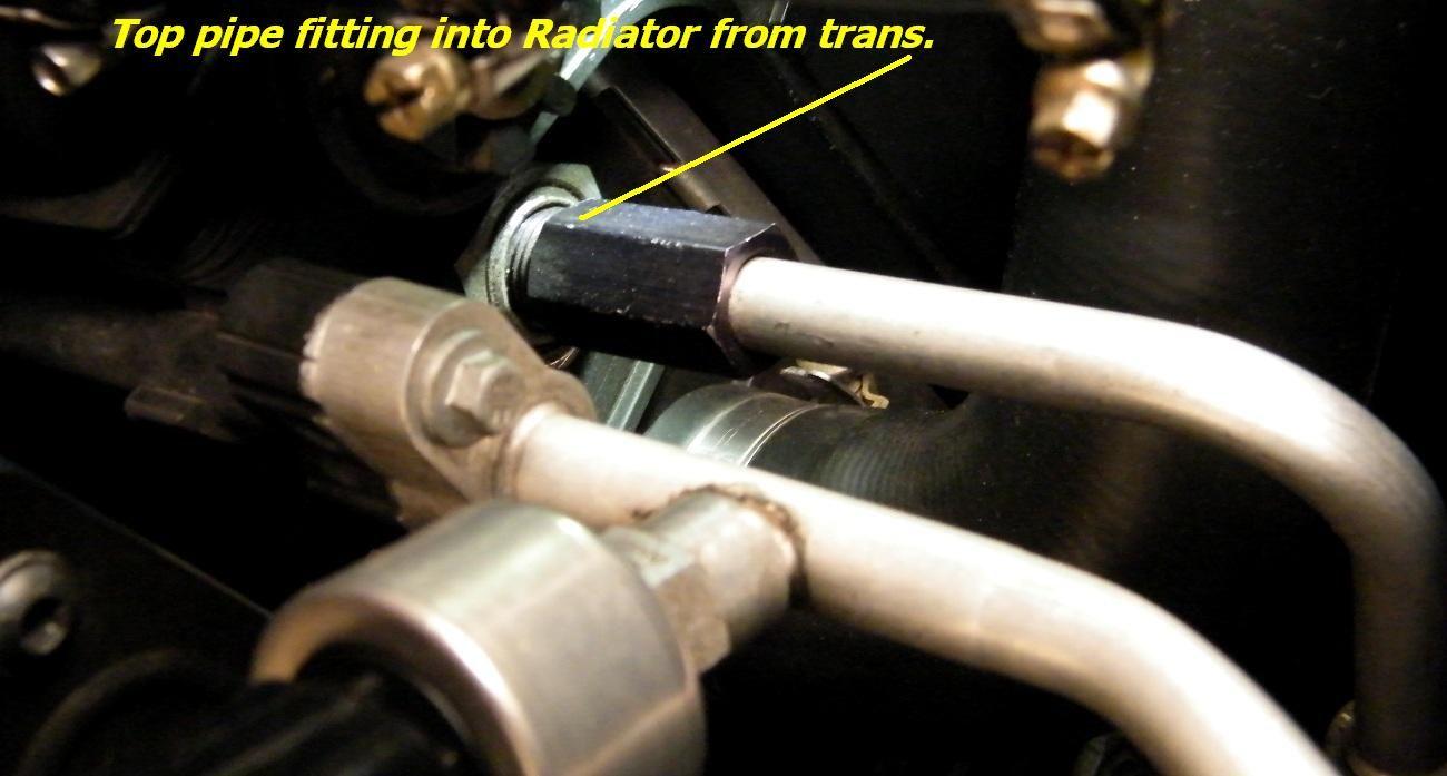

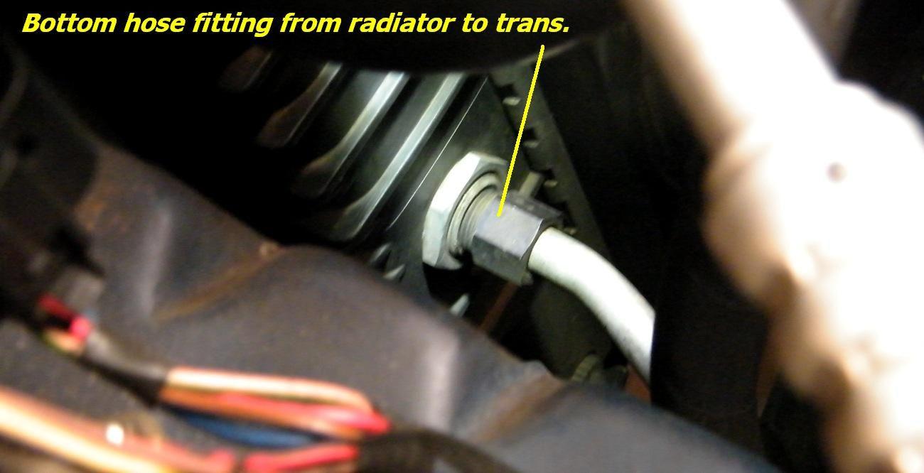

Greetings good people ;o)
before I go pulling things apart, can anybody tell me
the size and thread of the gland nut that holds the
transmission cooler pipe to the radiator top fitting?
The pipe itself is 12mm O.D. and as close as I can get
the gland nut male (external) thread seems to be 21mm....at a
guess ;o)
I will need to get a male bolt or tube fitting with male
thread and barb fitting to fit in place attached to tube to refill
oil and the other to drain the oil.
Will save a whole lot of mess and stuffing about if someone
can tell me the thread size thanks ;o)

18mm X 1.50

Hey Addicted....thanks for those measurements ;o)
Now I can go to my friendly garden centre and pick up
some cheap fittings ;o))
