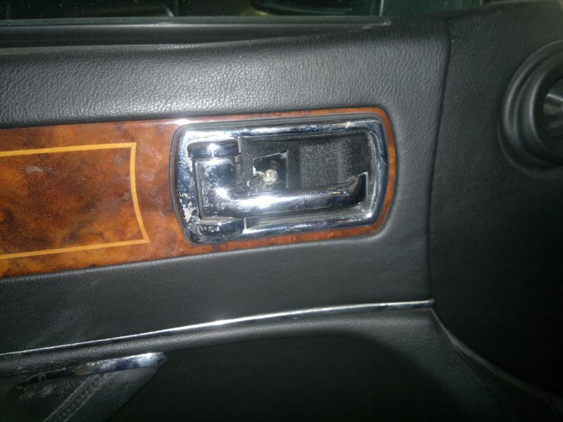

I have got an image for you .
You need to unscrew this bolt . Then you will have to remove the wood door panel . As far as I remember, after this you will have to lift up the upper door panel , just be gentle .
