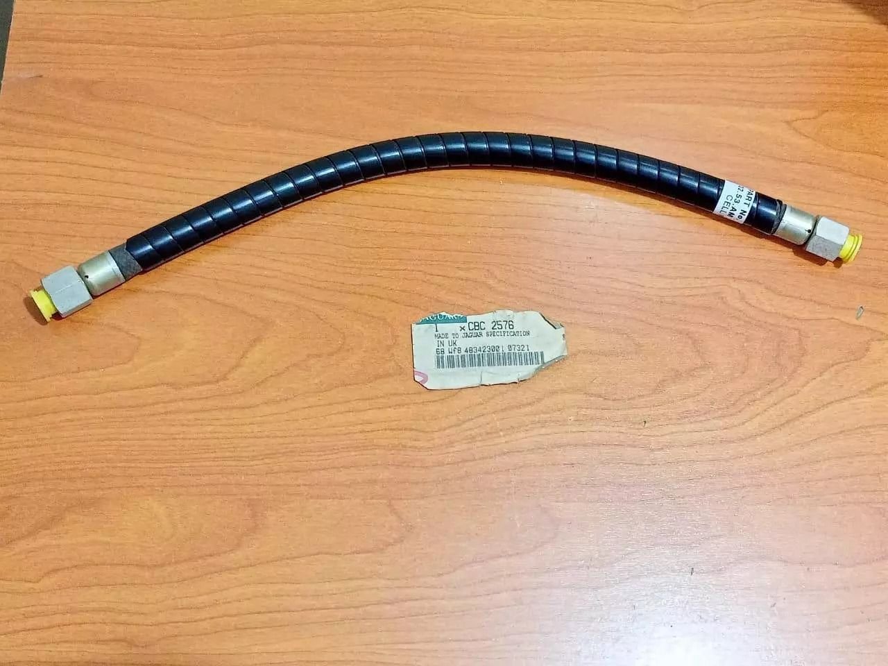

I'll have to get the filter and pump off later this week and investigate, but looking at this picture of the hose I found online, it definitely looks like the weird barb fittings used on places on my XJS.
If so, I could either: Replace the hose and leave the fitting off of the pump end, and use the standard Bosch pump I have for my XJS (assuming the hose is the same size), or at the very least replace the rubber hose and leave the fittings on both ends to keep it stock

As far as I can tell, the pumps are 100% identical (in terms of rated pressure and volume) minus the output fitting style. Even if the pressure were higher, it'll just bypass via the regulator and be sent back to the tank via the return line.
I just don't want to cut into the hose if it's not a regular barb fitting underneath the collars like I suspect, as it seems like that hose is quite expensive to get ahold of.
Even if I decide to not convert to the more standard fuel pump, I'd like to know if anyone else has replaced the rubber line and reused the end fittings, the line on mine from what i can see looks quite worse for wear, lots of microcracks going on.

However, judging by the condition of the hose, I will no doubt be replacing it before getting the car fully roadworthy. When the time comes, I'll cut the rubber off and see if it's replaceable by itself (I'm 99% sure it is since it looks identical to the fuel rail connections on my XJS)
