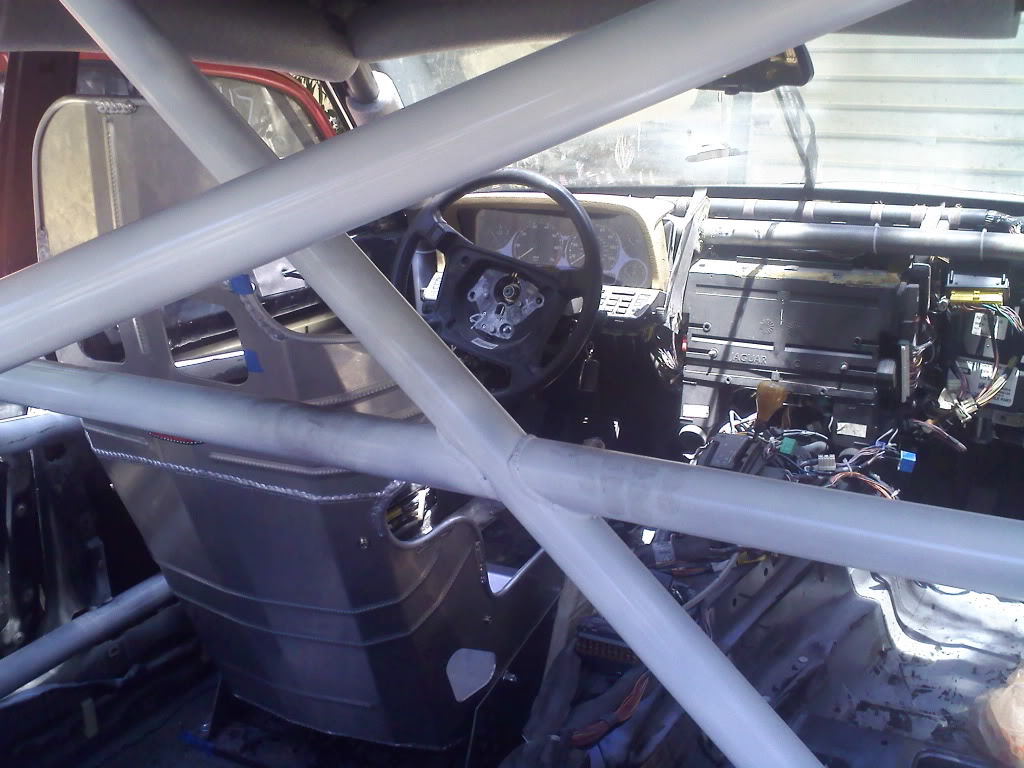

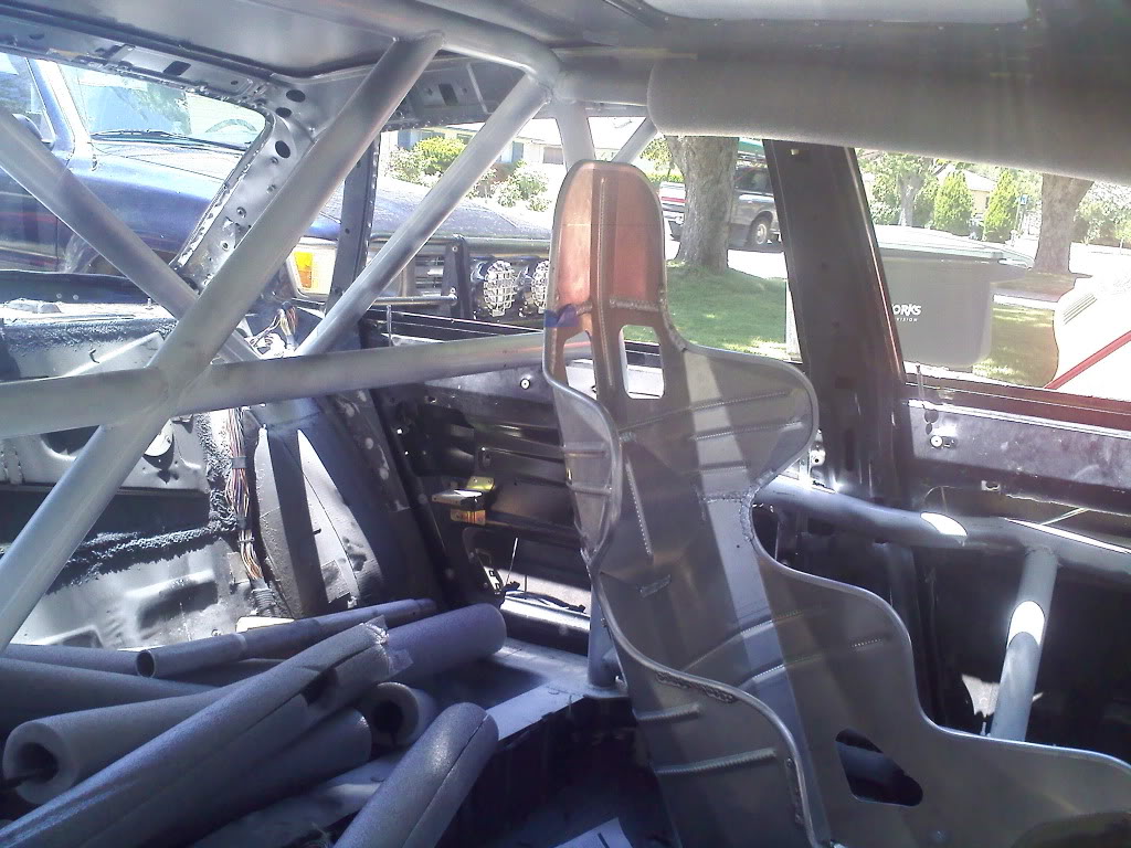

I am part of a team called Fraidy Cat Racing and we compete in 24 hours of Lemons in California. We ran 1 race last august and have been repairing our '94 XJ12 for our next race at Infineon Raceway in Sonoma. Everything has been going smoothly, but as of yesterday, we tried to start the car and it won't start. Keeping in mind that we have removed every non-essential part of the interior to turn it into a racecar, but have kept the stock instrument cluster for diagnosing simplicity. The little readout on the cluster just reads a bunch of jumbled half-letters when we turn on the power. We think that somehow we messed with the power to the cluster when we removed the turn signal, but don't know how. Any suggestions would be helpful. Below are a few pictures so you know what we are working with.

The car doesn't even turn over. All that we get, is a jumbled mess of letters on the dash readout when the ignition is turned to on and nothing else.
