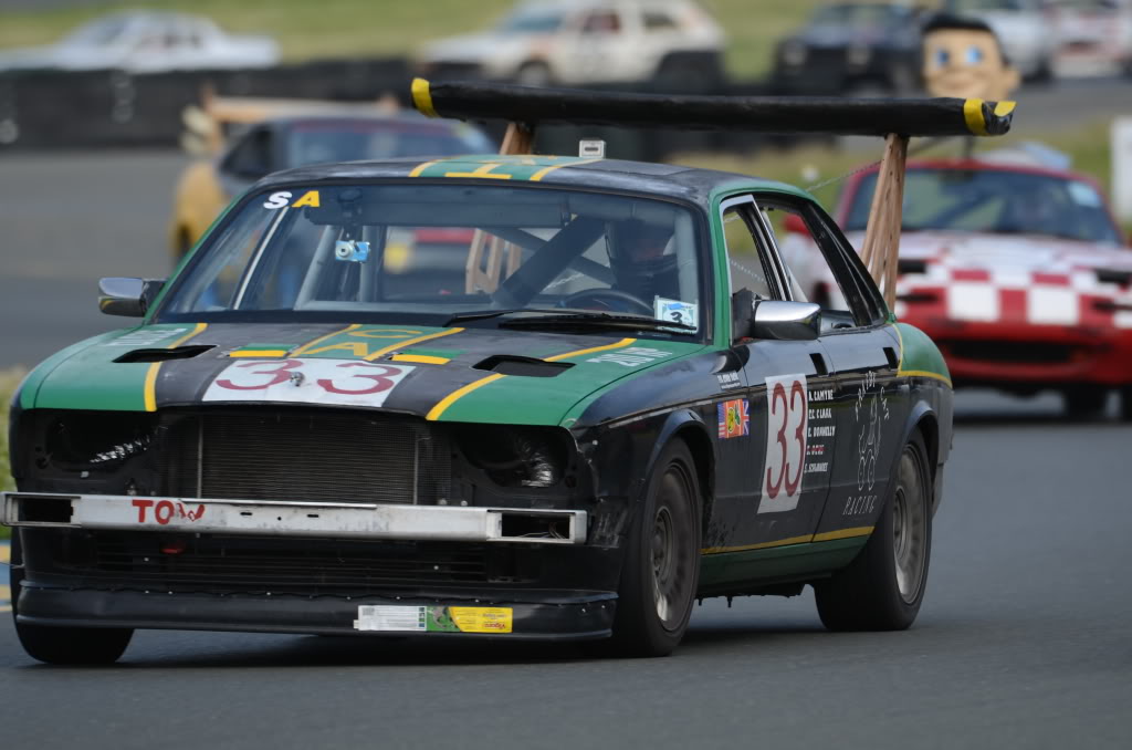

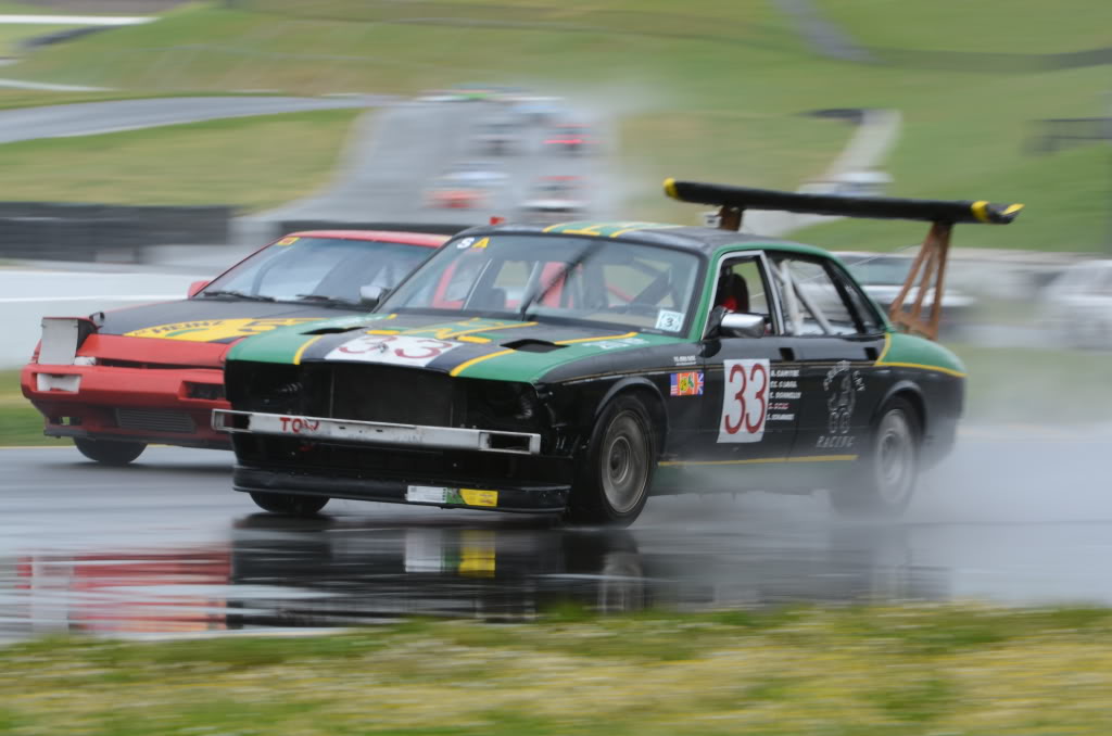

I am sorry to hear about the revving issue, but am glad that you figured it out. Once again, our team is glad that this car found a good home, but it is unfortunate that it had problems at it's first race. Hopefully it runs much stronger at Buttonwillow. I (Eric) am planning on being there as an arrive and drive, so if you need another, let me know. Ed may also be willing to Pit Crew for you if you need another set of hands and eyes. If you ever have any questions about what we did to the car and any nuances that you come across, shoot us a question and we will try to answer it. Oh ya, and the ECM codes have always been there. They are just saying that you are missing some fuses from blocks 1 and 2, and that the ABS sensors aren't working.
And now for some pics that were requested (from before the change in ownership). I am sure that Cheseroo will have more to post as well...

That explains why I thought I was seeing things.
Thanks for posting guys, best of luck for the future.
