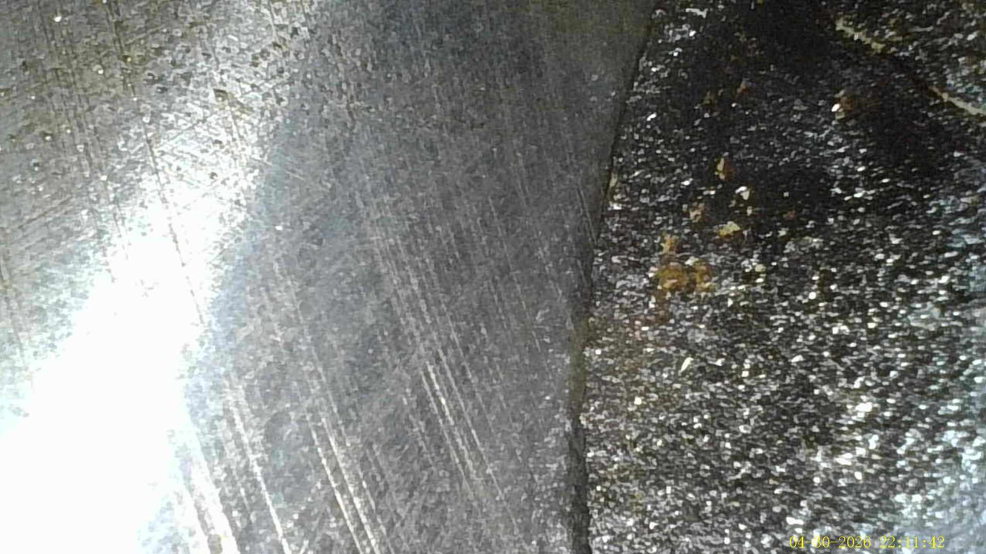

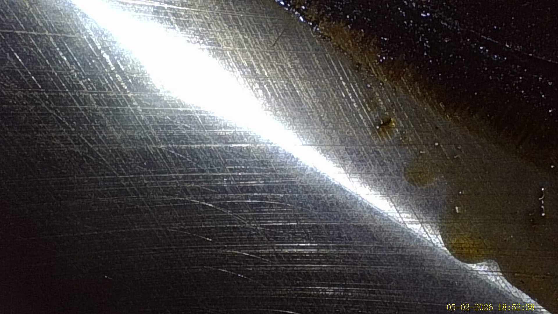

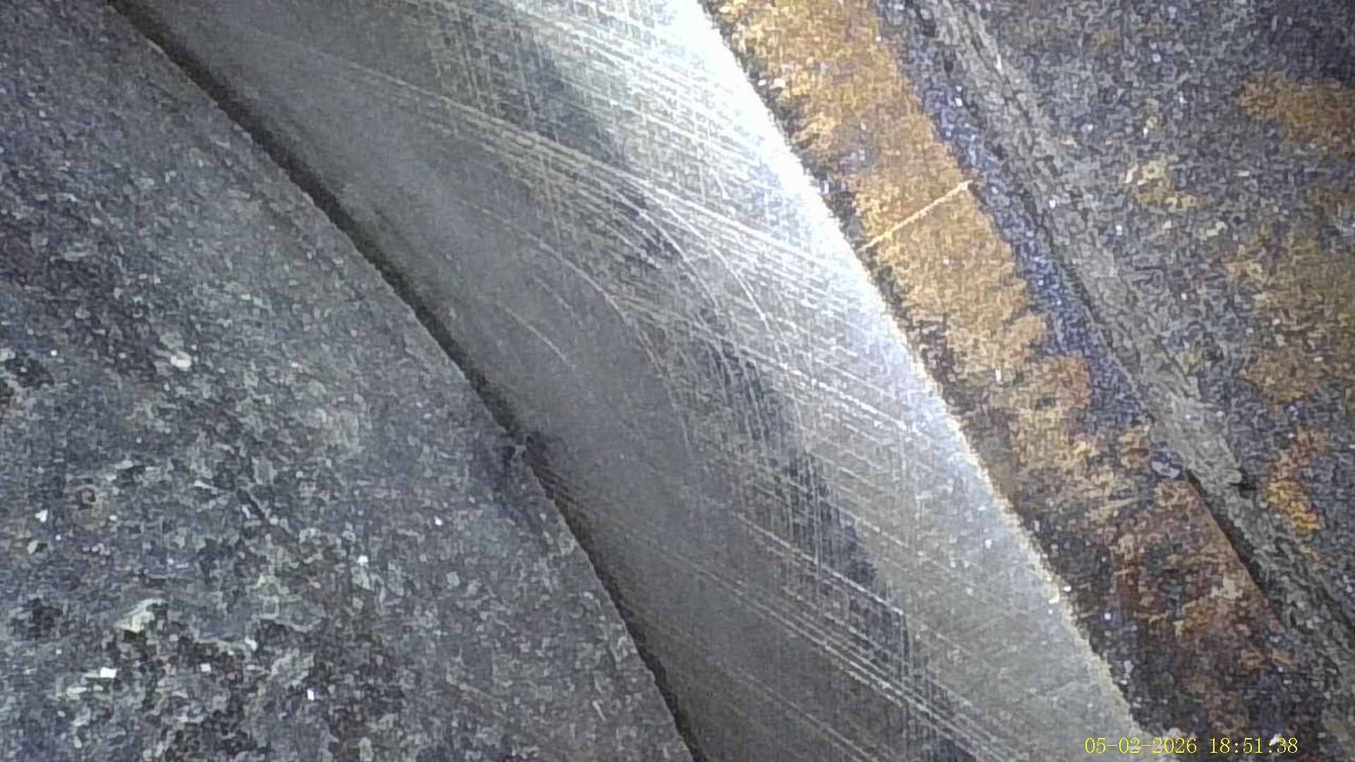

Got me an inspection camera and looked in to my cylinders. Mostly they look good, still can see the cross-hatching pattern on the liners, but most of them have burnt oil above the piston travel or even on top of the pistons, though this must be rather old.
cross-hatching
cross-hatching
burned oil margin
burned oil margin
On one cylinder there was pitting on the liner .. the engine probably stood for quite a while before I bought it.
Pitting
Pitting

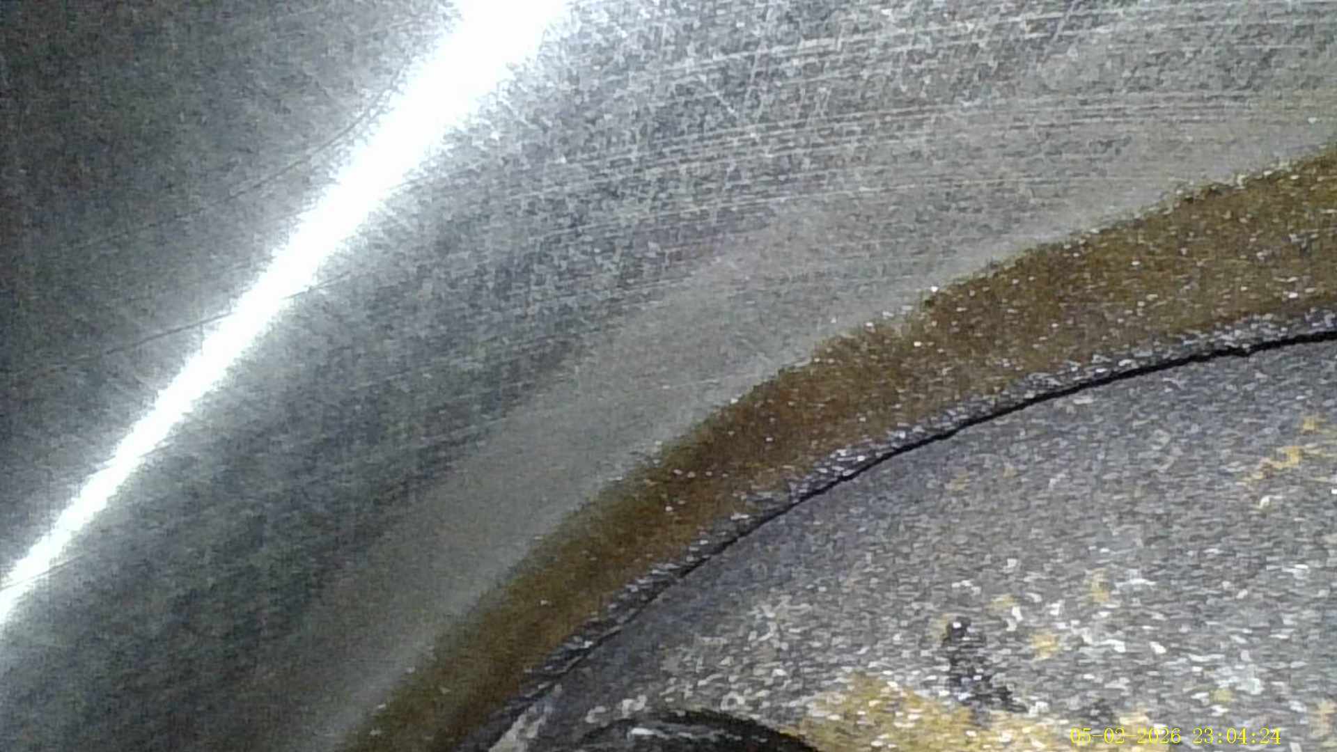

On one cylinder there was quite an amount of fresh oil on top, my camera has a limited angle but it looks like it doesn't go all around - probably my leaking head gasket.
oil leak
oil leak
Then there were 2 more cylinders with little amount of fresh or rather fresh oil, probably going all around - maybe bad piston oil seals?
oil margin
oil margin
oil margin 2
oil margin 2
And finally there is one cylinder where there is as mark going vertically ... I have made series of pictures of this cylinder and there is only one specific angle where this becomes visible.Could be piston play, marks from debris (the spark plug holes were full of it) or just a visual deception because the camera light reflects so much.
vertikal marks
vertikal marks
What do you think about this engine? New head gasket(s) and it will be good for the next .. let's say 50K km (this will cover more than ten years of usage) or serious work to be expected once opened?
Thanks
Oliver
